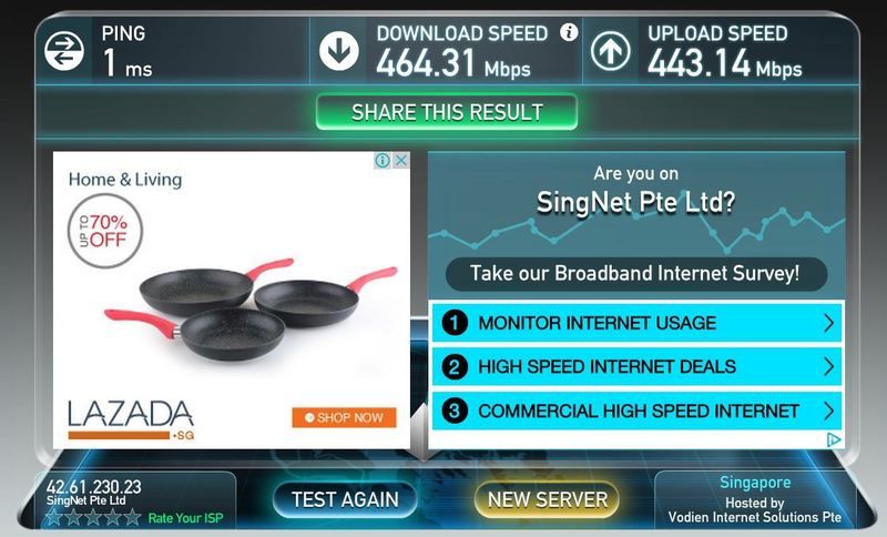

Hi voltech,
I'm on Singtel 500mbps Fibre. Took me a while to get these speeds:
I'm using RT-AC87 in place of the Singtel Aztech modem, and my PC is in the next room separated by a wall, using EA-AC87 as the media bridge, and the PC connected to the EA-AC87 through a cat 5E cable.
If you read back earlier pages - one of the key thing in getting good speedtest results was choosing the right "server" for your speedtest. It depends on your locale - for me Vodien gave the best result. Please note also for that particular server, there will be different results throughout the day too.
The other is choosing the right channel for the 5GHz. You will have to find out what channels your neighbors use, and avoid them. I also avoided connecting any other devices to the 5GHz channel too - setting most of the other devices(printer, Apple TV, handphones) to the 2.4GHz channel.
Hope that helps. :o
