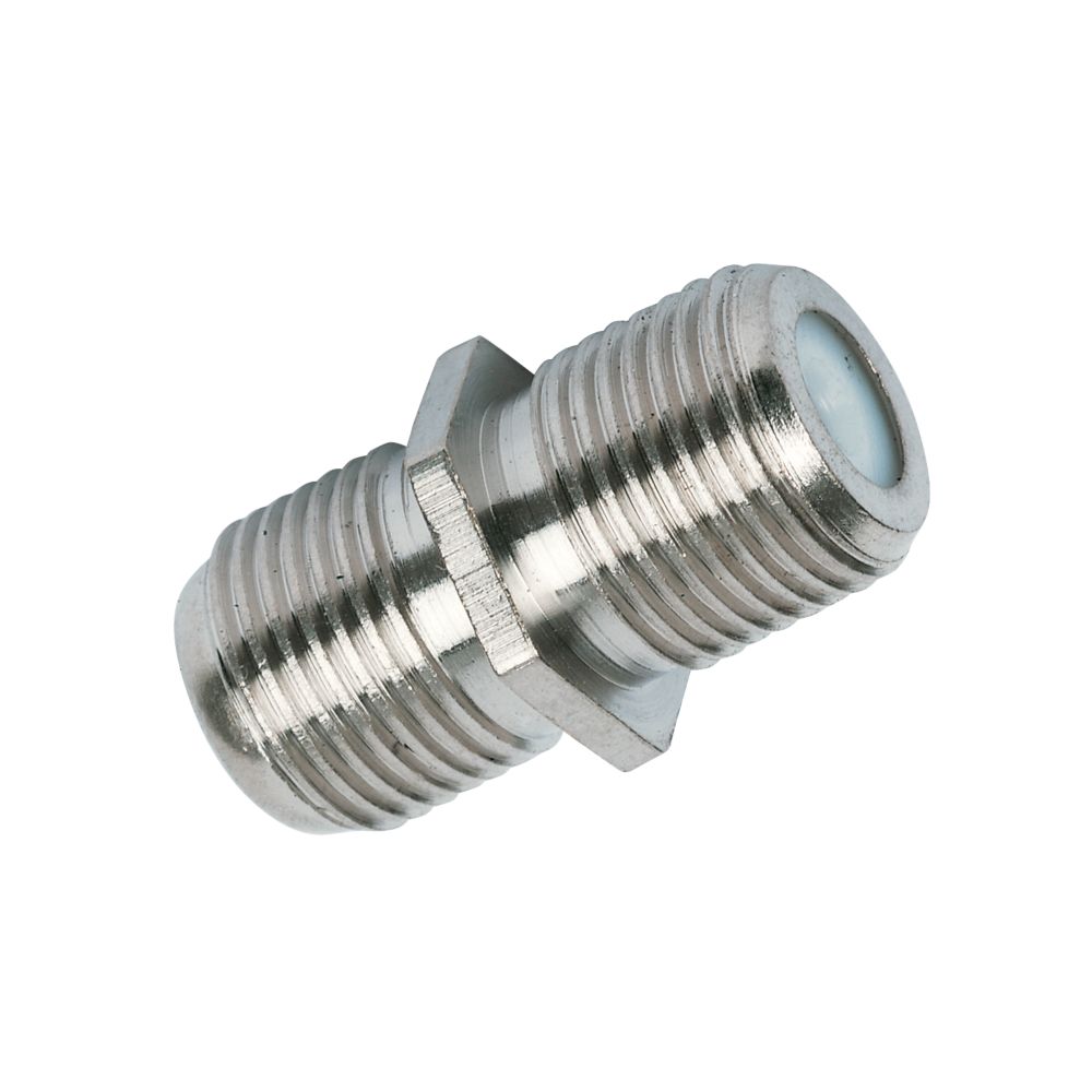

Well I meant Motorola MOCA Device. Yes it's the bonded 2.0 MoCA. Well I got the setup up and running but I'm only getting 100mbps as the speed on my PC in the room. Shouldn't I be getting Giga connection and the speed is near 1gbps?
I plugged out the main source of connection from Starhub to my splitter outside my house. Well it was the same with or without the connection from Starhub but to avoid my connection going out to other house hold I thought I better. The splitter is 5-1000mhz.
Direct measn NO SPLITTER!
Direct from one MoCA to other MoCA measn NO SPLITTER!
looking at the spec of MoCA
using splitter 5 -1000Mhz give you 100Mbps link
using splitter 5 -2300Mhz give you 1000Mbps link
moca 2.0 has to use ALL splitter 5 - 2300MHz to get 1000Mbps
if ONE of the splitter is 5-1000Mhz you get 100Mbps

Thanks. I got it figured. Now getting 1gbps connection to my PC instead of 100mbps but the speed I'm getting from my provider is about 400mbps download and 600mbps upload.
The 2x Motorola MoCA devices all came with POE filters. I had bought one thinking they wont. So those buying the Motorola MOCA device take note.
I'm not satisfied with the speed considering it could be faster. But I'm more than happy with it at the moment as our corner room has a speedier and more stable connection compared to wifi which gave me about 20-30mbps patchy connection.
I can't direct without a splitter. Maybe I change the splitter outside my house to the one I have which is 5-1675Mhz, and see if the speed improves. Keep you guys posted.

Maybe u should try to connect direct to check how fast it can go?
Or maybe u can tested out your house cable quality by skipping the splitter first? Use an F-to-F connectors to join the 2 cables:
ae235
And can try changing the MoCA frequency.
Add the POE at the splitter-in to maximise the reflected signal strength.
