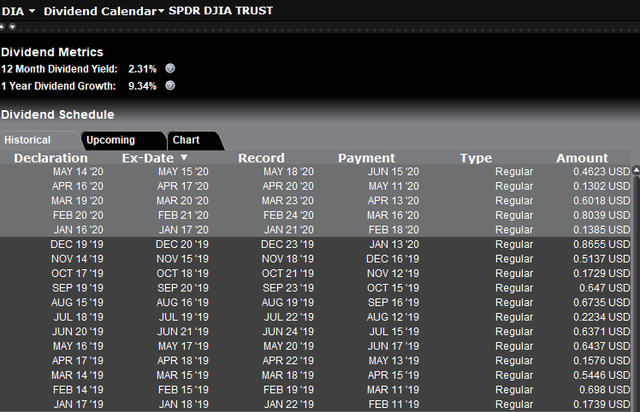

hi all, need your advice on this before i invest some serious money on this:
USX : DIA - SPDR Dow Jones Industrial Aver (1 share @ USD 254.35)
full image on this link : https://ibb.co/bPgMq6Y
is this worth investing? 12 month dividend yield is 2.31% . but they payout monthly.

In this thread people are only recommending ETF that reinvest dividends.
You come here to ask whether an ETF that gives monthly dividend is good? you should already know the answer you are going to get. :s13:
You'll want to read up on dividend withholding tax charged on American shares. Around here we recommend ETF domiciled in Ireland, read up why.
It sounds like you've picked a random thing to buy, just because it pays dividends monthly.
Let's step back a bit. What is your goal with the money you're investing? Do you want income, or capital growth? Do you want low risk, or are you comfortable with the price being volatile?
