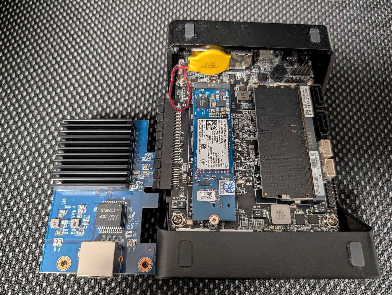

Field report on The new Realtek 8127 10GbE is working without problem on OpenWrt :cool:
