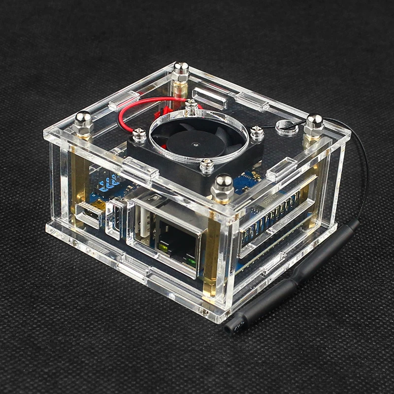

Yesterday, I successfully made one Pi-Hole myself with a cheap Orangepi Zero3 using LAN connection to my router. Effectively blocking ads, tracking, malicious, malware and other suspicious website.
As opposed to RaspberryPi for Pi Hole which most people use it, I attempted to use OrangePi for my project. It's small and effective chip, bought a case and small cooler fan in the case.
