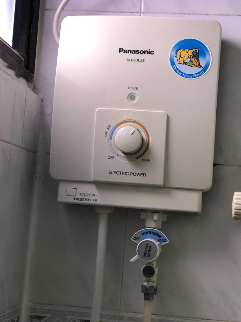

Almost all the cases or fatality from instant heaters came from self installation or from inexperienced and not certified technicians. :o
Now technology has improved.Got built in safety device to cut off electricity in the event of leakage.My old champs virgo 20yrs still working just that the inlet water hose needs to change due to wear but must remove the whole box hence might as well buy new set.
Skoda29
Feb 29, 2016
33,564
12,394
Water heater better be very basic with rccb, without superfluous functions and good to go for many years.
Nowadays many common electrical brands into IWH before that was handy only.
Good is the got rccb switch,booster pump/water v/v and the two hoses can be easily changed from outside w/o dismantling the box.
