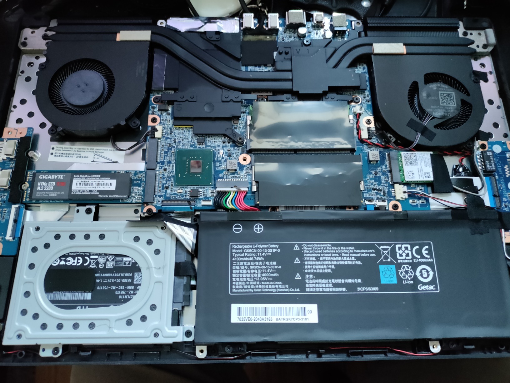

if you search evoo gtx in lazada, there is an intel gaming laptop selling for 788-$25 (year end voucher)=$763 only
laptop has rgb keyboard and extra nvme and sata slot.
laptop runs hot while gaming, but so does lenovo legion 5. Can be alleviated by changing advanced power options so the cpu runs at 95%, or add a registry key to limit max frequency, and buy a $10 laptop cooling pad.
the 48Wh battery isnt meant for gaming, only last 1h. but if you dont game while on battery, the gpu can be off in advanced power options so it can have longer battery life
All laptops will run hot under sustained load because the components like CPU and GPU will try and run as quick as possible when they have sufficient power and thermal headroom. There is no avoiding this in my opinion. Based on my experience, even if I changed the thermal compound to something better, I generally don't see a drop in thermals (if any, the difference in temps is very small). But I will see a higher boost clock speed.
i ended up undervolting by -300mV
cpu pkg power dropped from 25w to 15w.
