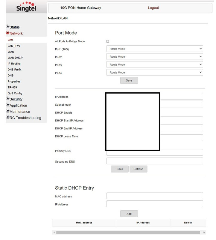

Old report about the successful bridging of Singtel issued Nokia XS-240X-A XGS-PON ONR. No bridging method has been posted in this froum.
BTW, Starhub is configuring the Nokis XS-240X-a as an XGS-PON ONT and it is the default ONT used by Starhub 5Gbps/10Gbps users.
I now keyi bridge 3 ports, keep calling 1688 disturb them then a tech came down change for me a nokia ONR. All good now
@BlonkBloink managed to sort out the issue with an totally unexpected way -- he got a new Nokia XGS-PON ONR which he can bridge.
https://forums.hardwarezone.com.sg/threads/singtel-5gbps-enhanced.7030365/page-7#post-153407206
@BlonkBloink
Would you be able to share the model number of the Nokia XGS-PON ONR? Thanks.
When you say bridge 3 ports, do you mean that you get 4 public IPv4 addresses? Or 3 public IPv4 addresseses? I remember 4 is not possible.
And just wondering if you can get IPv6 to work or not. If yes, native IPv6 or 6rd? Thanks.
Reference: only two users get Singtel native IPv6 to work with the ZTE F8648P ONR.
https://forums.hardwarezone.com.sg/threads/singtel-5gbps-ipv6.7053976/
https://forums.hardwarezone.com.sg/threads/ipv6-discussions.6976522/page-8
As attached, 1 routed 1 bridged, total 2 ips tried 3 it broke LOL. Model number all that was advised by the tech to not release first
Also dont have ipv6 native. 6rd works but ping is crazy(dont use it)
