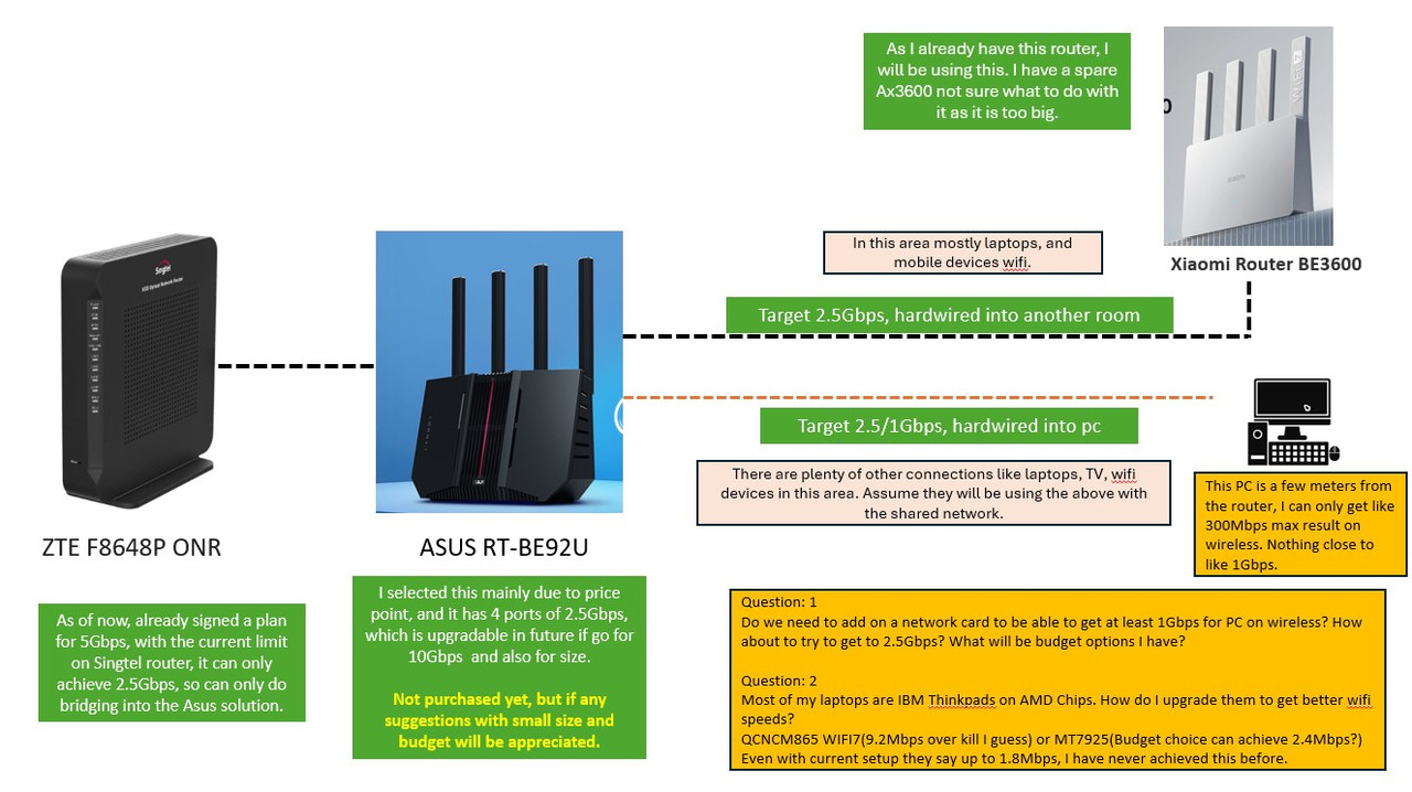

Hi all,
After reading through more of the recent pages, I understand now that the Singtel-provided router is limited to 2.5Gbps on the WAN side.
I’ve just signed up for the 5Gbps plan and I’m planning to bridge it to an ASUS RT-BE92U. I have a few questions and would appreciate any advice:
1. PC Wireless Speed
My desktop is only a few meters away from the router, but on Wi-Fi I’m only getting around ~300Mbps max, even when using an aftermarket USB Wi-Fi adapter. It’s nowhere close to 1Gbps.
  • Do I need to install a dedicated PCIe Wi-Fi card to achieve ≥1Gbps over wireless?
  • And if I want to aim for ~2.5Gbps speeds, what are some budget-friendly upgrade options?
2. Laptop Wi-Fi Upgrade
Most of my laptops are Lenovo ThinkPads (AMD-based). I’m looking to improve their Wi-Fi performance.
  • Would upgrading to a QCNCM865 Wi-Fi 7 card be overkill?
  • Or would a more budget option like MT7925 be sufficient (e.g., able to achieve ~2.4Gbps)?
  • Even though the current Wi-Fi cards are rated up to ~1.8Gbps, I’ve never been able to get close to those speeds. Any common bottlenecks I should check?
Thanks in advance for any guidance. Much appreciated!
Attached below a rough setup.

Hi all,
2.5G WAN Speed limit of the HB611-SGST will in general not affecting your max WiFi speed. Okay there are some devices which can exceed 2.5Gbps but only at very close range and may not be consistent.
1. What is the built-in WiFi adapter? Or your USB WiFi adapter?
Fast USB WiFi 6 or WiFi 7 adapters are able to break 1Gbps barrier but not 2Gbps barrier as of now.
No cheap options if you aim for 2.5Gbps WiFi speed on AMD platform. Only MT7927 and QCNCM865 based WiFi 7 adapters are able to do that and only on 6GHz band.
If your WiFi adapter is rated at AX1800, you should be able to get 600Mbps to 800Mbps if the connection is good. You can check if the Link speed is 1201Mbps or not.
2. MT7925 should be good enough for most users, you will be limited to about 2Gbps. But if you have the budget to pay for QCNCM865, no issues with that as well, especially if you aim to get above 2.5Gbps WiFi 7 speed.
Some users here are good at finding lobangs and managed to get MSI NCNCM865 based WiFi 7 adpter below S$60.
3. Please read the following threads for typical WiFi Speed.
Your AX1800 rated adapters --> 2*2 AX 80MHz, real world speed can be about 600Mbps to 900Mbps.
MT7925 --> 2*2 BE 160MHz on 5GHz/6GHz band, real world speed can be at about 1Gbps to 2Gbps.
NCMCM865 --> 2*2 BE 320MHz on 6GHz band, real world speed can be at about 2Gbps to 4Gbps.
https://forums.hardwarezone.com.sg/threads/wifi-7-device-speedtest-and-wifi-7-adapters.7048233/
4) 2x2 AX/AXE/BE 80MHz, 1024QAM, up to 1201 Mbps, real world speed is at about 600Mbps to 900Mbps.
5) 2x2 AX/AXE/BE 160 MHz 1024 QAM on 5GHz and 6GHz (6GHz is only for Wifi 6E or WiFi 7), up to 2402 Mbps, real world speed is at about 1Gbps to 1.8Gbps.
6) 2x2 AX/AXE/BE 160MHz 4096QAM on 5GHz and 6GHz (6GHz is only for Wifi 6E or WiFi 7), up to 2882Mbps, real world speed is at about 1Gbps to 2 Gbps.
(4096 QAM is non-standard for AX/AXE).
7) 2x2 BE 320MHz 4096QAM, up to 5764Mbps, only for 6GHz band, real world speed is at about 2Gbps to 4 Gbps.
4. You can also read the following thread.
https://forums.hardwarezone.com.sg/...rmance-only-60-70-of-what-they-claim.7006382/

2.5G WAN Speed limit of the HB611-SGST will in general not affecting your max WiFi speed. This one problem leh, i sign 5Gbps, becos i want to split 2.5G to 2 different locations as in 2.5G to each room, so maybe need a router to do this. I might do a direct cable to my PC and likley i might need a network card.
1. This is PC wireless, onboard motherboard wifi. I think this is a wifi 6 AX200 160Mhz variation on realtek systems. Ah i see, that means if my Mother board support a M2, i can get either one than. QCNCM865/ MT7927 solution, is taobao a viable option for this? I think it will solve No. 2 and 3 also.
4. I am using a comfast wifi 7 usb adapter, but results just about 300Mbps upload and download. Will a MT7927 beat this? There seems a few options from TP Link on the PCIE Cards with Wifi 7.
