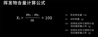

Volatiles include the oil that is baked and the gases that volatilize at high temperatures, and each silicone grease grill can basically smell a refreshing smell when opening the beaker, which is the smell of the calculation formula caused by the volatiles, which are caused by volatiles. Calculate Formula Formula as follows:
1658021079878.png​
The volatile content of each silicone grease is shown in the following table, with Limin TFX having the largest volatile content, followed by silver silicone grease.
