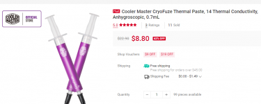

Good thermal paste with "stock cooler" also can perform wonder actually if no intention to overclock, example of R23 multicore reading below of i7-11700 (65w cpu limting factor by cpu cooler) using Cyrofuze paste with evenly spread method:
Do take note of the CPU package power and temp
*Updated with 10min Throttling test) @ 2.9Ghz All core @ 0.92v - Average 69c @ 65W (observed during test for 10min)

This one like TFX very dry type
I am not too sure how dry is considered dry :LOL: but personally I am using this as daily paste both in 5900x (aio) & 11700 (stock cooler) now,
perhaps the video below can show better image of dry :
