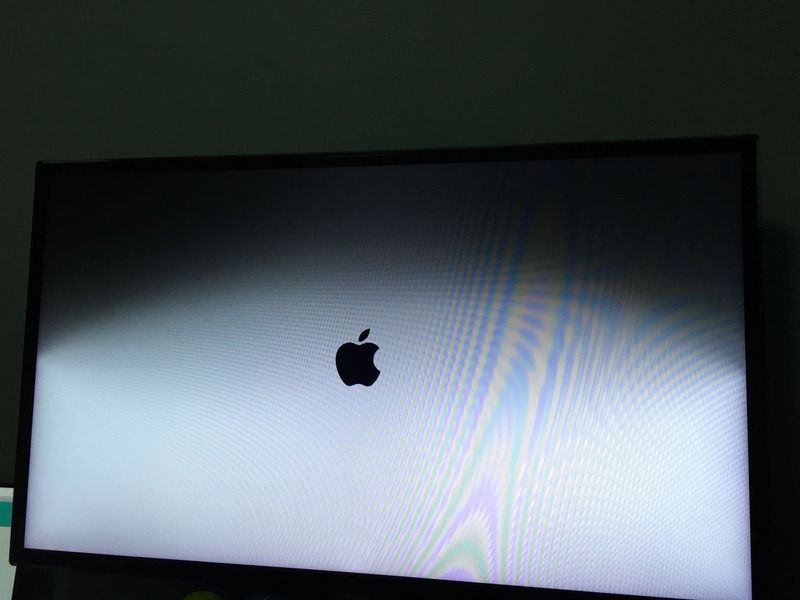

Hi Guys,
I have a Samsung LED TV which the warranty has expired.
The top part of the TV like the "light" spoilt. Graphic still can be view, jus tat is darker.
May I know is it worth to repair this TV?
