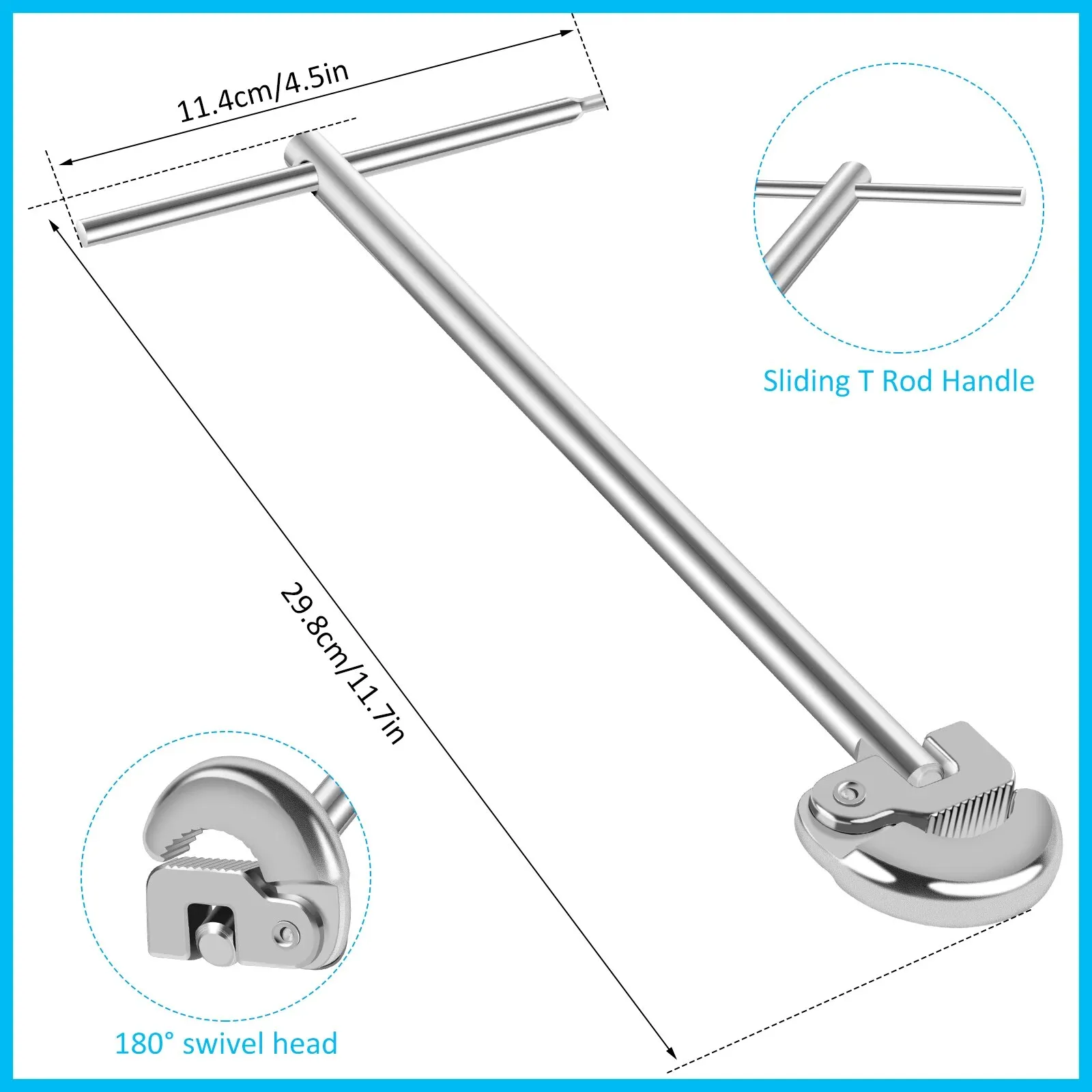

This is the one I use at home
This is the correct one. Just need to get the correct size. All others are waste of time.

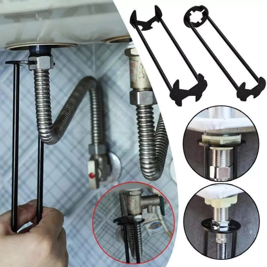

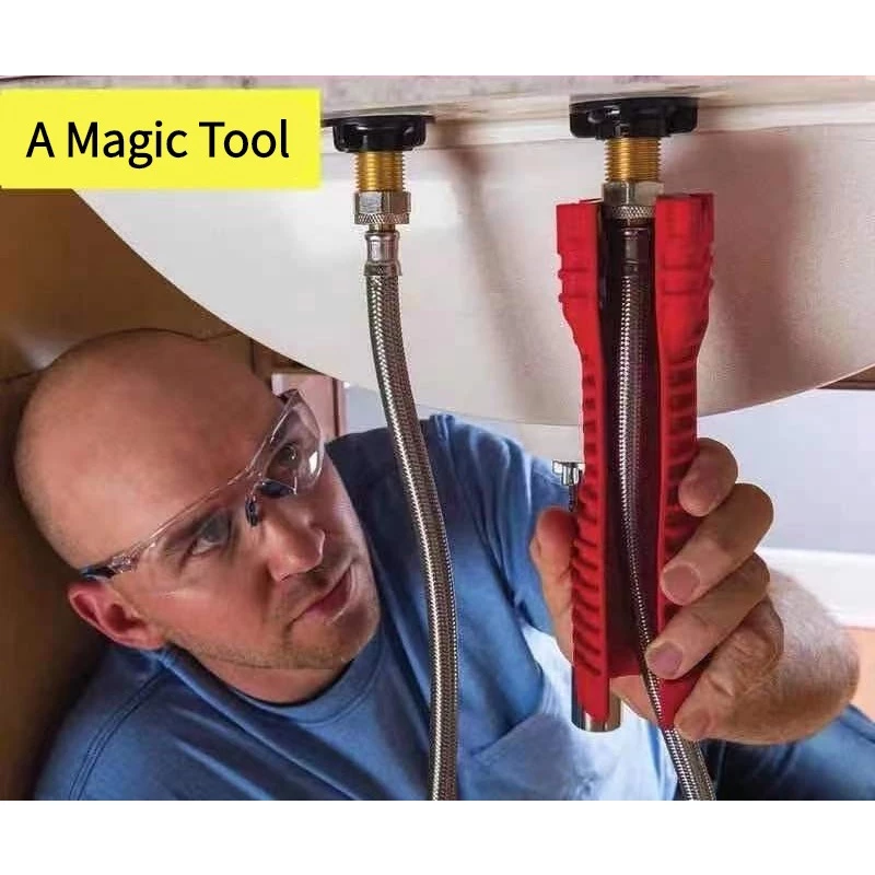

Am replacing my basin mixer water tap.
I see that there are 3 different types of wench available to use in tight places.
Those with experience can advise which wrench to buy?
No. 1, No. 2 or No. 3?
Thanks
My underside of the water tap.
It is a very tight space. The left side (white colour is the sink)
2 is better.
coyote
Sep 20, 2000
75,492
23,662
Those indeed are the best. Though have to remove the hose first before tightening or releasing. No. 2 however can tighten or releasing the nuts without disconnecting the hose and can be useful in certain circumstances.

All no good, there is another one which looks like a steel pipe, the plastic one no. 2 is usable but flexes if you need extra tightening torque, the rest are awkward to use.
