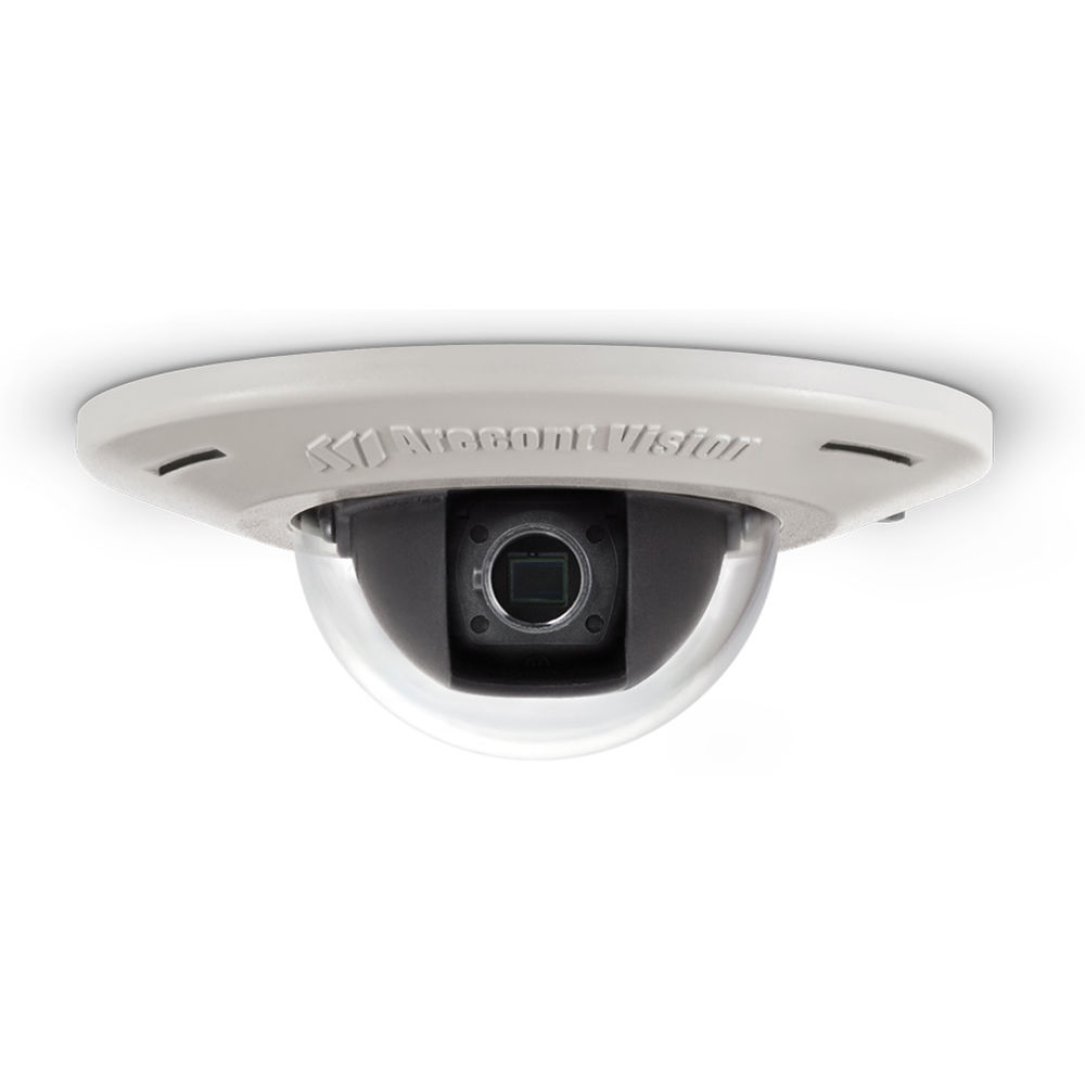

Wireless IP Camera thread
skintigh
Mar 23, 2016
38
Got a Sineoji PT528V yesterday from the estore, Dean have it installed today. Great service and very satisfied overall.
CCCustom
Jul 18, 2012
37,283
10,791
Hi guys, I am looking for a ceiling-mounted camera that is as low profile as possible and can pan. Something where the lens is in a half-cup rather than in a ball, like this:
Is/are there any such inverted flying saucer cameras that are recommended?
localITguy
Suspended
Dec 13, 2013
17,788
1,674
Hi guys, I am looking for a ceiling-mounted camera that is as low profile as possible and can pan. Something where the lens is in a half-cup rather than in a ball, like this:
Is/are there any such inverted flying saucer cameras that are recommended?
in-house or out door?
wingshya
Jun 14, 2005
8
Hi guys, just bought a Sineoji PT 498V camera and had problem activating my email notification using gmail. had set the following already but still no receive any email from gmail. Will like to ask if the sender email same as Receiver1 email? Need to set at FTP side? Anyone can help? Thanks in advance.
Sender:xxx@gmail.com
SMTP serve:smtp.gmail.com
SMTP port: 465
SSL: SSL
Alarm: Motion detect sensibility: 7
Go to preset position on alarm: 1
Send email: ON
Record when alarm: ON
Alarm clock for all 7 days: ALL ON
Dave27
Jul 21, 2001
310
Hi guys, just bought a Sineoji PT 498V camera and had problem activating my email notification using gmail. had set the following already but still no receive any email from gmail. Will like to ask if the sender email same as Receiver1 email? Need to set at FTP side? Anyone can help? Thanks in advance.
Sender:xxx@gmail.com
SMTP serve:smtp.gmail.com
SMTP port: 465
SSL: SSL
Alarm: Motion detect sensibility: 7
Go to preset position on alarm: 1
Send email: ON
Record when alarm: ON
Alarm clock for all 7 days: ALL ON
Sensitivity should set to 1, 7 is the least sensitive.
You will receive a notification from Gmail about allowing other devices to authenticate. So you ought to give permission to allow it, otherwise, the motion alert will not come through.
Select all the schedule from Mon to Sun 24 hours in the alarm schedule.
wingshya
Jun 14, 2005
8
Sensitivity should set to 1, 7 is the least sensitive.
You will receive a notification from Gmail about allowing other devices to authenticate. So you ought to give permission to allow it, otherwise, the motion alert will not come through.
Select all the schedule from Mon to Sun 24 hours in the alarm schedule.
I half tried but still cannot. Got anything to do to the FTP? My FTP now not default setting. How do i revert back to old setting?
sgnimo
Dec 6, 2015
41
what is the correct way to mount an ipcamera ? The bracket is screwed on the wall, the ip camera should be standing up on the bracket or be inverted ? referring to the sineoji PT528V
Tyer
3,645
Guys. Sorry to trouble the experts here. Anyone tried to connect Vstarcam ipcam, C7824WIP with a Synology NAS DS214play? When i add camera using surveillance station 8.1, I am able to see the camera details (Ip address etc). However, when i click on the test connection, it failed.
Do I need to do something else?
cherryblossoms
Mar 9, 2017
2,235
can sineoji cam be shared to multiple devices?? meaning 2 - 3 fam member can view the live ip cam on the phone/pc anywhere.
My main worry is, lets say im oversea long term and the cam somehow got disconnected. will my 1 fam member at home be able to reconnect the ip cam so that i can view it again in oversea all the while?? thanks
AcEz874
Jul 25, 2007
2,953
267
can sineoji cam be shared to multiple devices?? meaning 2 - 3 fam member can view the live ip cam on the phone/pc anywhere.
My main worry is, lets say im oversea long term and the cam somehow got disconnected. will my 1 fam member at home be able to reconnect the ip cam so that i can view it again in oversea all the while?? thanks
I installed the PT528V and it can Set-up on 4 Smartphones (android/iPhone) also can use web interfaced version :) the cam won't be disconnected as long as your router and your cam didn't turn off, it's really a good iP Cam! very fast response time.
Phases
May 24, 2005
9,342
1,042
Which brand of nvr is reliable? Looking at one with 16 to 24 channel recording.
Phases
May 24, 2005
9,342
1,042
hikvion lor.
or an OEM of hikvison:o
k. thanx.
Btw, i notice the model number of dahua on taobao is different from those on their website, there seems to be have local and international diff. Is this correct?
