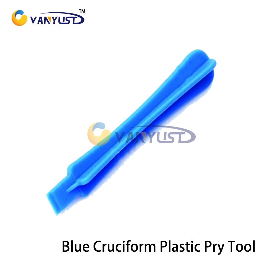

I bought from below link, you need a plastic tool to open the phone casing so as not to dent the casing, screws can just use philips screw driver, xm don't use those iphone screws~
https://www.aliexpress.com/item/303...32797105028.html?spm=2114.13010608.0.0.e4ZBFS
