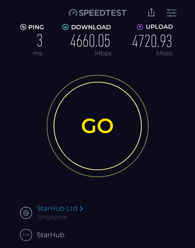

any updates on your testing?
I have ordered the same adapter, I am having troubles with stability running it on USB3.1/3.1 Gen2 ports on both windows and linux. MacOS no issues
Download drivers here:
Type-C Multi Stream Transport (MST) Dock or Adapter
https://www.wavlink.com/en_us/drivers.html?keyword=wl-nwu340g
I received mine and have no issues with it after updating drivers. Using a type c 20gbps connector.

WL-NWU340G Rev. A. For your issue, have you tried it with any other windows laptop etc? What do you mean by instability? For me, after system bootup, it takes about 1-2 seconds to initialise and then i am connected to LAN.
Not sure if it'll help but i'm running 13900k/ MSI Z790i Edge desktop, as well as 7840HS Lenovo Slim 7 laptop. Both works fine.
Elijahonli
Oct 27, 2008
25,846
159
the adapter randomly disconnects or disconnects when conducting a speed test.
I tested with a Dell 7060 which has a usb-c 3.1 10gbps port as well as my desktop B450I with USB A to C adapter as my PC doesnt have a usb-c port .
xiaofan
Sep 16, 2018
37,055
12,569
Maybe power related issue.
I have two Comfast/Fenvi brand USB 3 to WiFi 7 adpters (both using Type A and not Type C) and some times they will also drop when carrying out SpeedTest.
Interestingly it is better if I use the USB extension dock from Comfast.
On the same Acer Swift 3 laptop (Intel Core i5-1135G7 CPU), no issues when I use the USB4 /TB4 port with my two USB 4 to 10G Network Adapters from IOcrest/GRiS, probably the USB4 /TB4 port can delivery more power.
Anyway, I am also buying the Wavelink USB 3 to 5G network adapter for testing purpose. Let's see how it performns on my system. I tend to believe it will work on my laptop's USB4/TB4 port.
