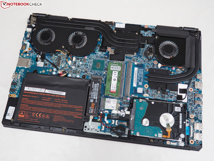

Not sure yours what model. Mine Prime 15, opened up, near the top (near display hinge), it's all heat sink and fans + motherboard below only. Battery is just next to HDD below the keyboard area, the whole stretch from the left to the right of touchpad.
https://www.notebookcheck.net/fileadmin/_processed_/e/4/csm_fireks_23_66a00ececa.jpg

mine is same as urs.
oh so its the battery that get ******* hot. always bottom right below the numpad damn hot
Take a look at your chassis see got deform or not. Most likely the battery bloated already. I removed mine for quite sometime d maybe I should throw it away rather than keeping it inside my room become a hazard.
