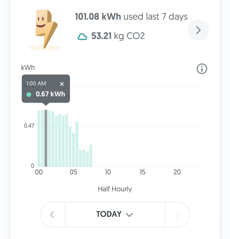

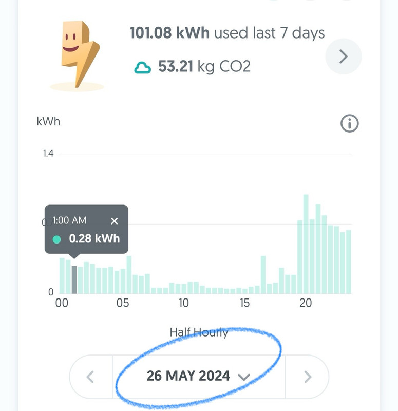

Hi all, may i know what is the power consumption for a 9k + 12k fancoil with 4H33VG compressor running at 24c low fan speed?
Just change my aircon 1 month ago, realise today from sp app that the power consumption increased a lot compared to when just installed.
Any kind soul can help to explain?
Weather hot la.
