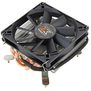

Of course, knowing that airflow is extremely restricted, I used a branded CPU cooler instead of the stock one. The Xigmatek Praeton LD964.
Not too big, not pathetically small. Still, using a FM2 socket AMD M-ITX motherboard, things get pretty heated up. This forced me to flip my power supply fan so that the fan blows instead of sucks, fan it inwards towards the CPU hoping to give it some direct fresh air from the outside.
