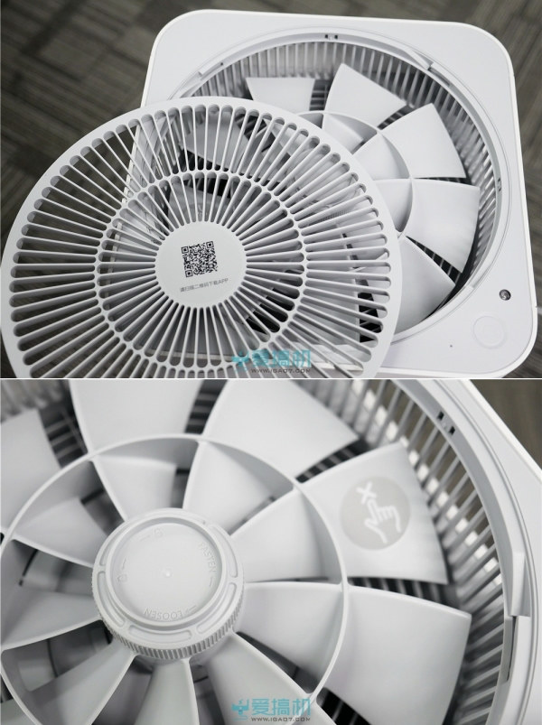

There's dust on the blades and the side walls. Thus need to wash it off.
Is that so? I thought the filter would have done the job of trapping the dust in the air before the air reaches the fan blades. Humm.:s11:

Believe Xiaomi AP 1 mixes in some intake air first before blasting it out through the fan at at the last stage. You see the side intakes?
I suspected this would present itself as a small issue, but never thought that it would accumulate so fast.
XM AP 2 no such issue.
This is also why you read folks saying that the Xiaomi 1 is very powerful, much more powerful than other fans. Or Xiaomi balancing a ball at the intakes etc.
In an APed room here in Singapore's usage context, you would already have an aircon blowing/mixing air also though, so seriously it's not totally necessary.

But i guess over a longer few moths of accumulated usage, some dust would start to accumulate at that inner wall as well, so it'd be pretty difficult to get rid of totally unless you wrap a wet tissue onto a stick and dig in. (ie first picture above, the inner part of the body shell of the AP, due to eddy air currents). Coz there are only 2 side holes.
The issue i see is that it would accumulate over a long period during normal usage. Once you blast jet mode, some dust would be blown out. Not unlike a dirty fan that you have not washed for very long time.

Mixing air is to prevent bypass.
I notice even sharp a50 has a small outlet blowing air out to front, that is on top outlet.
As for balancing, it's a marketing gimmick by xiaomi. I am an engineer, basically all rotating parts need to be balanced if not it will shake itself to bits and tear the rotating component and/or damage the bearings. It's very important for high rpm devices.
You can compare the desk fans sold in ntuc those power pac and those Panasonic and kdks.
Just a cheap marketing ploy by xiaomi.

Xm2 top can't be open only xm 1 can
PHP:
[QUOTE][/QUOTE]
My blades. After 1 month of usage
