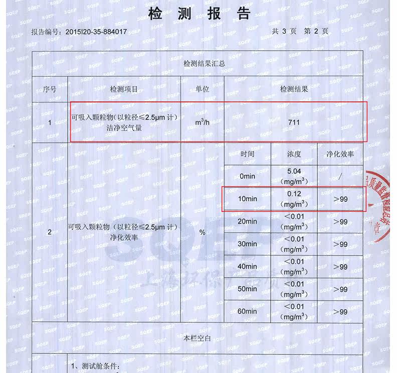

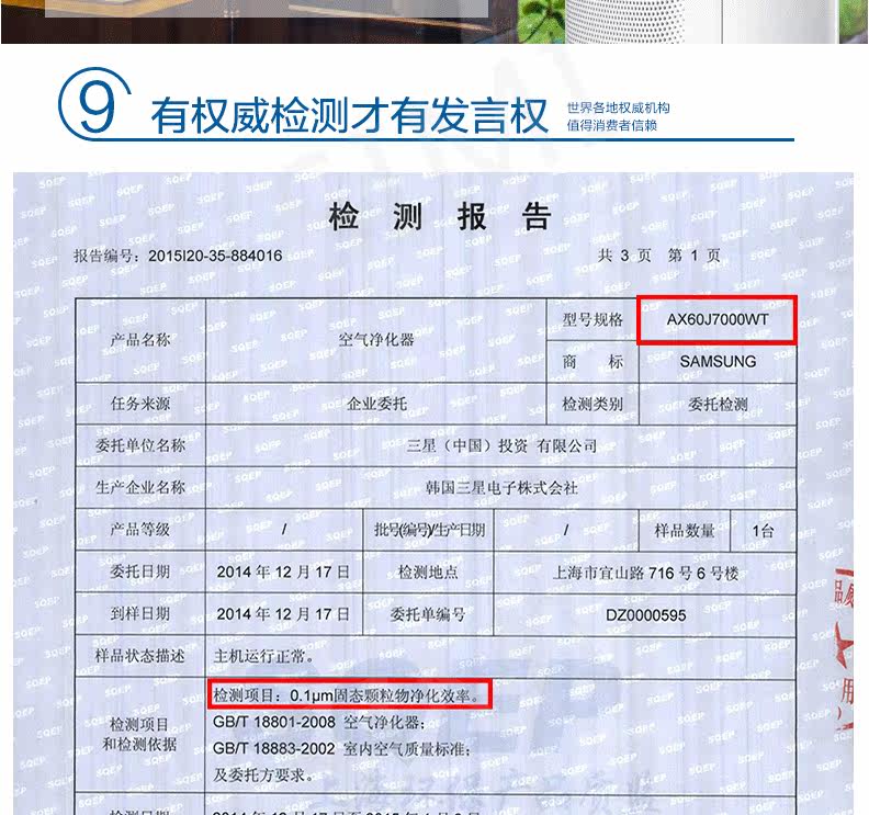

Qoo10 now can see the Samsung AX60 and AX70, both seems to be priced at $615.
AX60 = 711 m3/hr
AX70 = 773 m3/hr
Both are very silent for its airflow. And very energy efficient.
Those folks who cannot get a good price for the Sharp A80, can try this one.
This is more than enough for even the sickest kid or elderly who just recently came out of a major op and resting in a big Pasir Ris 5-rm(140 sqm) Master bedroom . :D
http://list.qoo10.sg/item/SAMSUNG-AIR-PURIFIER-BLUE-SKY-PM2/425129631
WussRedXLi
Jun 15, 2001
96,294
12,086

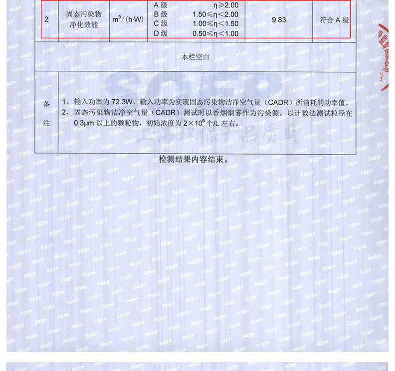

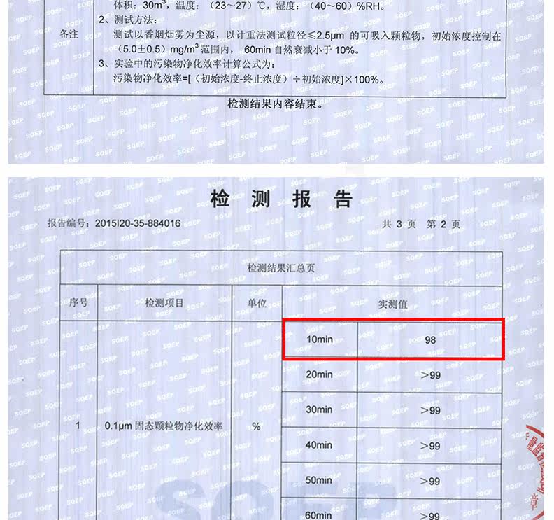

The Chinese run their tests in their standard 30 cubic metre test chamber.
5040 ug/m3 -> 120 ug/m3 in 10 mins. :eek:
WussRedXLi
Jun 15, 2001
96,294
12,086
Official korean specs
47W, 48dBA for the AX60. 711 m3/hr
70W, 52 dBA for the AX70 773 m3/hr
Sharp A80 is doing 480 m3/hr for 75W.
Used 12hrs daily, difference of 23W = SGD22 per year, or SGD110 5 years.
Slight dip of airflow (8%), 4dB difference which is a heck lot.
I'd say go with the AX60.
