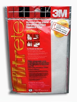

Ok, finally I think Amazon refreshed their 30" x 60" 3M filtrete.
Now is FSSG with usd125!! (Last time wasn't eligible)
Throw it into your next purchase from Amazon!
30" x 60", or 76cm x 152cm.
Red colour grade, good enough, see my tests above.
It would be a fair bit cheaper than Taobao (taking taobao to be 0.5kg weight = 12 RMB, cheapest is 109 RMB, total = 109 + 12 = 111 RMB, add 3% TB fee and 2.5% CC charge). Easier to use, since your regular Aircon 9000 btu/hr is 30cm x 30cm filter. So slices into 3 x 5 pcs (25cm by 30cm) = 15pcs. 2 packs = 30 pieces.
Taobao size of 38cm x 180 is difficult to utilise. Unless you slice into 19 x 30cm pieces (2 x 6 = 12), which the Amazon size also can slice to ( 4 x 5 = 20)
http://www.amazon.com/gp/product/B0009H78OK/

SG retail selling S$17.90 for a 38cm x 60cm size for the red 3M Filtrete.
NB, last time I cheong Amazon that time never put FSSG. Else I'd have stocked up real good.
Anyway, Amazon would be US$3.50 instead of S$17.90 for the same size.
If you buy Amazon FSSG, it's good as a filler item as well.
