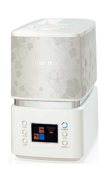

Just to share on my bad experience with my Novita air humidifier NH900. I would suggest everyone to keep away from this model.
The model has 3 mode of mist form where level 1 has minimal or no mist at all whereas level 2 and 3 have about the same amount of mist. What ticks me the most is the unacceptable noise level when the water are following thru the passage. The water doesn't seems to flow smoothly and will only refill after a certain period of time, so the noise of water flowing (around every 20 mins or so) is louder.
Another thing is the water indicator sensor which goes off whenever the water tank is empty. (4-5 short beep like alarm clock) My sensor went malfunction and will beep even thou the water tank is still full. If leave unattended, the water will flow again and after sometime later the sensor would beep again (fake water depletion indicator).
As such, I will be awaken either by: 1) The loud water flowing (every 20 mins), 2) The constant water depletion beeping sound (every 1 - 2hr).
I've already brought the set back to Novita for 3-4 times, but the problem is still not fixed. Really feel sad for this machine as I paid $300 bucks for it.. Now it's just rotting at one corner.. :(

Thank you wrx bro for introducing this AP, I set it up to work last night and it was running really quiet (auto mode instead of sleep mode). I can feel that the room was cleaner as my nose irritation gets milder.

Wow, that particular Novita humidifier is so bad. Mine is the basic, costed me S$79 only but it was very long time ago, like 10 years ago. Just have a basic humidity level control (eg set the humidity and also mist level/humidification rate knob.
Really very basic, just fill her up and set the levels, done.
It seem to me Novita use different manufacturing facility and just put own label
In Russia your model sold at name Electrolux EHU 3510D/3515D
Made in Korea Produced by Lihom as I remember
Also bad impressions from customers:D

Your Novita is one of the best ultrasonic humi.
In Russia sold under name Boneco Air-O-Swiss 7136
But owners not able to reach specs data
330 ml/h as max
