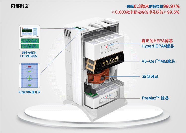

2 units of IQAir HealthPro 250 on gumtree. $600 for 1. Seller said he'd give disc for getting 2.
The HyperHEPA is about $350. But if don't mind the smell from daily operation, can last 2 years. It's crazy thick, 14"x14"x5" thick. So cannot DIY
Whole set of filter (H10 prefilter, AC and potassium permagante or something like that, HyperHEPA filter) = 3200 RMB. Or $700.
