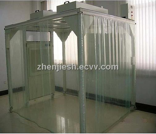

sound like u guys re going to build clean room :s13:
this 1 confirm safe from haze
:s13: clean room not yet.
but for new house owners, esp those BTO in non matured area (next few yrs all sorts of construction going on) or at least the first few mths where ur surrounding blocks are all still under construction and reno, an AP helps for those who have sensitive nose or respiratory issues.
