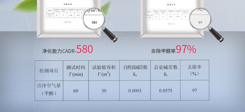

More mountains more folds, get mountain fresh air now
It's true.
Pure data :
M8088A 728mm filter, 202 mountqains.
Convert to 310mm filter, it's 86 mountains.
72.8cm x 40.1cm = 2919cm2
Samsung AX40 310mm filter, I count 75 mountains.
Area = 31 x 28 = 868cm2
M8088A is 3.36 times area of AX40.
Depth is the same.
Overall surface area is like 3.9X that of AX40 media.
Filter is H11 though, but airflow velocity is very low, not sure how's the PM0.1 performance.
Guess that's how it gets 584 m3/hr (measured) or 580 m3/hr spec with 70W. 520m3/hr with 48W. 326 m3/hr with 29W.
This is despite the AX40 filter having a better filter media with lower hPa drop than the PP media of the M8088A. Just by sheer brute surface area of close to 400% more but at decently low price. No rocket science.
