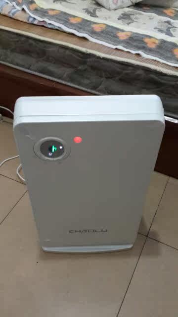

HEPA Filter size is 10 inch by 11 inch by 1 inch. But if you forgo the AC filter, probably can free up some 0.5 inch. So the Fellowes HF-230 and Vornado MD1 True HEPA filter from Amazon can cut and fit.
The stock filter is most probably some HEPA10 or something.
Comments all say output airflow is strong. (can't totally trust the specs)
Only RMB299/SGD60. 4PX forwarder shipping probably SGD35.8 or so. (from what I read, nobody kena volumetric wt before by 4PX)

Actual product photo by customer

Any1 can tell if this purifier is using HEPA filter? I can't find it in yr product description.
IT's a tiong product. As of now, the best guess I can give you is that it's HEPA10. It's v difficult to say, am sure you'd have heard of "bait n switch" that the USA folks always describe ah tiong products.
If you want a True HEPA air purifier that's up to H13 standard, then get a True HEPA replacement filter from Amazon, fill her up to usd125 consolidated to enjoy free shipping....there are lots of things to buy from AMZ actually. The Fellowes HF-230 is Made in Korea, Vornado MD-1 not sure. Need to trim and tape up the sides to eliminate bypass though.....but it'd do and it'd fit.

PS. One buyer reported that the front cover cannot close, needed some masking tape.
