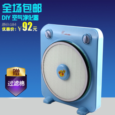

Instead I got those circular filter (RMB48, free ship to 4PX), Japan Home sells the Powerpac fans for SGD16.90 at my place so no need to ship from taobao. Filtration airflow is low, but it'd do coz I got 2 filters. And 10X easier to store. :)

Bro, you are referring to Box fans is it?
Any link to the taobao filters?
Yeah, box fans. The small ones.
Search for
HEPA 过滤网
HEPA DIY 过滤网
Sort by highest sales volume.
There are 2 sizes that I have seen. 275 x 15mm and 290 x 20mm.
Some sites give you cotton prefilter, some don't.
BTW, the airflow is very low, so do not be surprised if you put it in front of the box fan and there seems to be really low output.
But if you see on smartfilters website, the guy did a Dylos laser air particle counter test with this in a 15sqm room which is like our newest HDB MBR size, it can clean decently in 60 mins time. The drop is around 70-80% micrograms per m3 of PM2.5 and PM0.5, so that's really decent.
I'd just have to tape 1 HEPA in front of my iFAN and another one to my box fan, which I have yet to buy. I don't think i'd buy it, coz downstairs Japan home is selling.
Should be enough to lower and maintain say PSI 300 conditions to ~ PSI 100 condition for the living room within 2 hours. ie choking to the healthy individual -> still can tahan

Ok, like you, I was pretty sceptical, even with smartfilters doing the laser particle counter testing.
Check out the smoke clearing video here in this taobao listing as well as constant drop on the Dylos Laser Particle Counter. IT's youku, so I cannot embed
hepa
And also this
http://particlecounting.tumblr.com/...directly-comparable-tests-diy-versus-blue-air
1. Is the air coming out of the purifier clean? This is the easier question to answer, and my tests are as clear as can be. The DIY purifier shoots out very clean air.
2. But is that enough to actually clean the ambient room air? For example, if you have a really tiny filter and a huge room, the filter could work properly but still not be strong enough to make a difference.
Answering this question is more difficult because you need a controlled environment (you can’t open and close windows during the test), and you need to test the air for a longer period of time. Fortunately for you, I’m a nerd, and I’ve been doing these tests for fun for the past few weeks.
RAW Data for the box fan in the 15 sqm room. Biggest drop is in 1hr mark, continues to slowly drop till 2nd and 3rd hour.

Cheap HEPA from taobao measured here on the first page of particlecounting site. 92% efficient. That's like between HEPA10 and HEPA11. Not too bad.

Ok, finally found the taobao page of SmartAir Filters. The original guy who started it all.
Ê×Ò³-Smart Air-ÌÔ±¦Íø
His HEPA filters are tested to be True HEPA, H13. But definitely significantly more expensive than the other taobao sellers, naturally due to the higher quality.
His tested another DIY fan + filter combo (ard H11 quality) and found it to be 21% slower in cleaning (as posted above)
