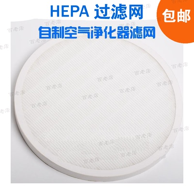

The taobao ones have prefilter, either comes as a set with the HEPA or you get it separate for like $1 or so.
I posted a few times liao. Here it is :
Various diameters, 25mm thickness. But more expensive than others.
Ô²ÐÎDIY·çÉÈÓøßЧHEPA¹ýÂËÍø£ü´øÄÚ¿×HEPAÔ²ÐιýÂËÍø£ü³§¼ÒÖ±¹©-ÌÔ±¦Íø
29cm, 20mm thickness. Cheaper.
Ô²ÐÎHEPA¹ýÂËÍø DIYÖÆ×÷HEPA¿ÕÆø¾»»¯Æ÷PM2.5¹ýÂËÍø HEPA¹ýÂËÍø-ÌÔ±¦Íø
