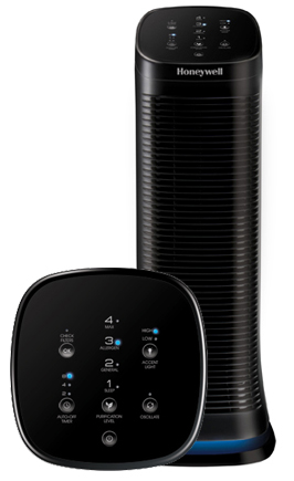

Yep, agree....a good way to make use of the HIGH on the big cylindrical honeywells is to zhua them in HIGH with nobody in the room for a short period of time. The performance CADR vs price ratio is great (Amazon price which includes shipping and factor in $70-$80 for a good 750W voltage convertor) and one of the best out there. Just can't get past the voltage convertor thingy, occupies quite a bit of space as well.
This "turbo" mode, which is too loud for sleeping for most models out there, ensures that the room is cleaned very fast and completely. Air-purifier-power.com mentioned that before, 1 hr in HIGH/turbo is better than 12 hours in low or perhaps even medium.
I like the Honeywell QuietAir Airgenius that a bro posted earlier in the thread, nice design and very slim footprint with decent performance. Just can't get past the voltage converter thingy, must really really get a very good convertor to reduce the fire risk.

but actually the vertical type I am pretty skeptical cos of the usually way of generating wind (aka fans) it is never close to the normal rotary methods
With the PSB safety sticker is cool, also advocated that in the air purifier thread last year. For those who has no option but to get an air purifier from AMZ, go for this. Just that, you know we locals are usually v price sensitive and so go for much cheaper options coz the good voltage convertors are not that low in cost. There were a few with burnt purifiers here (50150 also, some using 200W convertor for that) due to this also when the cheap 300W voltage convertors go poof despite the 50250 drawing 50W/120W/170W in L/M/H.
Bo bian lah, i know the tower fans not that efficient....but really for the looks to fit the decor. My Sharp is nice in design IMO but my wife already wanted to kill me when i got it. Even the Blueair can forget about it, i showed her the 650E long time ago coz i wanted to buy, due to the large footprint. With a big 500 or 750W convertor sure forget it one....
