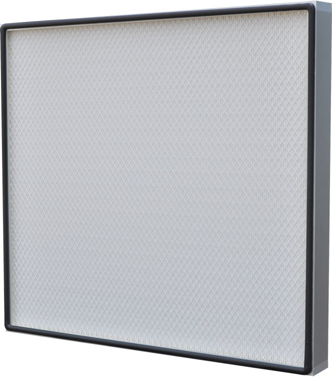

Got my H13/H14 filter from taobao.
Fiak, 5.4kg weight!!! 610x610x50mm size. The aluminium sides quite heavy I think, followed by the packing. The thing is that for these cleanroom HEPAs, they need to pack it securely for transportation as long as it leaves the factory, else any degradation = fail during the DOP test.
5.4kg = S$27 shipping.
Unit cost = S$43.
Total to SG = S$70 shipped, or usd54.4 if wanna compare with Amazon.
The only good thing is that it'd fit as 4pcs for the Samsung AX40. Or SGD17.5 per piece or RMB 88 per piece, everything in.
Still ok for a 50mm or 2-inch filter. ie Compared with say a Novita NAP501 (0.75 inch HEPA portion, 10 x 11 inch size), this is 2.66X in thickness, will hold 2.66X more particulates, while presenting less resistance + more air flow capability.
If specially order a HEPA without the aluminium sides, I guess they'd charge extra for this customisation. So also LPPL. :D
铝框无隔板高效过滤器|H13高效过滤器|H14无隔板高效空气过滤器
ÂÁ¿òÎÞ¸ô°å¸ßЧ¹ýÂËÆ÷|H13¸ßЧ¹ýÂËÆ÷|H14ÎÞ¸ô°å¸ßЧ¿ÕÆø¹ýÂËÆ÷-ÌÔ±¦Íø
As quoted :
0.1 microns efficiency = 85%
0.2 microns efficiency = 99.9999%
铝框无隔板高效过滤器结构:
外框:铝型材,表面阳极处理
过滤效率:99.97%-99.999%(H13、H14) MPPS
滤料分隔: 热熔胶
出厂前逐台激光计数扫描检测
滤料:玻璃纤维滤纸 MPPS=最易穿透粒径
密封胶:聚氨酯连续运行温度:≤ 80°C
密封垫:聚氨脂/闭孔氯丁橡胶压条
耐湿性:≤100% RH
保护网:钢网喷塑,白色RAL9016,
进出风面均有金属护网。 .
专业制造技术保证气流均匀、阻力低、寿命长;
铝型材外框、表面阳极处理;
进/出风面带金属护网;
可提供69mm、80mm、90mm、96mm、110mm等多种厚度;
可提供垫片干式密封,刀口液槽密封等结构型式;
逐台激光扫描计数MPPS(0.1-0.2um)效率:85%-99.9999%(EN1822);
