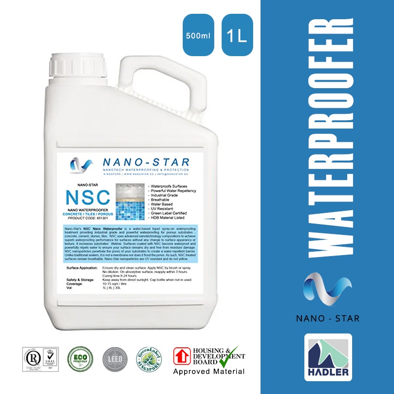

wet patch & small water droplets?
Usually, if the leak is dripping kind, it's small cracks in the waterproofing upstairs. It can be fixed by spraying 'nano water proofing' solution. I have done it DIY and for $80.
sg-11134201-7rbm9-lnv6teqkymk009
So u did the nano spray to ur ceiling, or went upstairs to nano on ur neighbor floor?
HDB is only accepting hack & redo, or apply the solution I mentioned at in my last post , I was told by a HDB officer about this. It's expensive, out of blue and troublesome, gona be a long long long procedure if the parties can't agree.
I had this problem n it was told that the neighbor upstairs has to stop using the bathroom for few days as its hack n redo, and would cost my neighbor n us $300 each.
In the end, we didnt redo but just patch the crack. One plus years liao, the paint seems to be moist slightly n i think drip might came back after a few more years.
My shower water leaked downstairs so I applied it onto my toilet floor.
I will pay $300 to solve this problem tho, it's so cheap.
But for my time, HDB asked me to find a private contactor. The quotation for apply this nano thing is already 2k+
