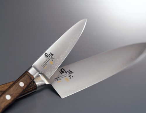

a good steel knife can last very long huan, even with regular sharpening. my normal kitchen knife receded like 0.5mm after 2.5yrs of usage, with sharpening every weekend. it would prolly last 25 yrs to recede 5mm b4 i change a new knife. the sharper knives would prolly last a century since i sharpen them only once a mth and their core steel ish very hard, can hold the edge can tahan the wear and tear better.
this is one of my normal kitchen knife, kai 5000cl series, made in japan. the edge receded 0.5mm now. but still far from reaching the wavy line of the cladded steel yet. prolly would take another 20yrs. this series is considered pretty sharp for home use and ish not expensive. the larger gyuto and santoku would be ard $60 a piece in japan and the smaller ones 1/2 the price.
the same coy had some made in china ones so be careful if u see cheaper ones.
