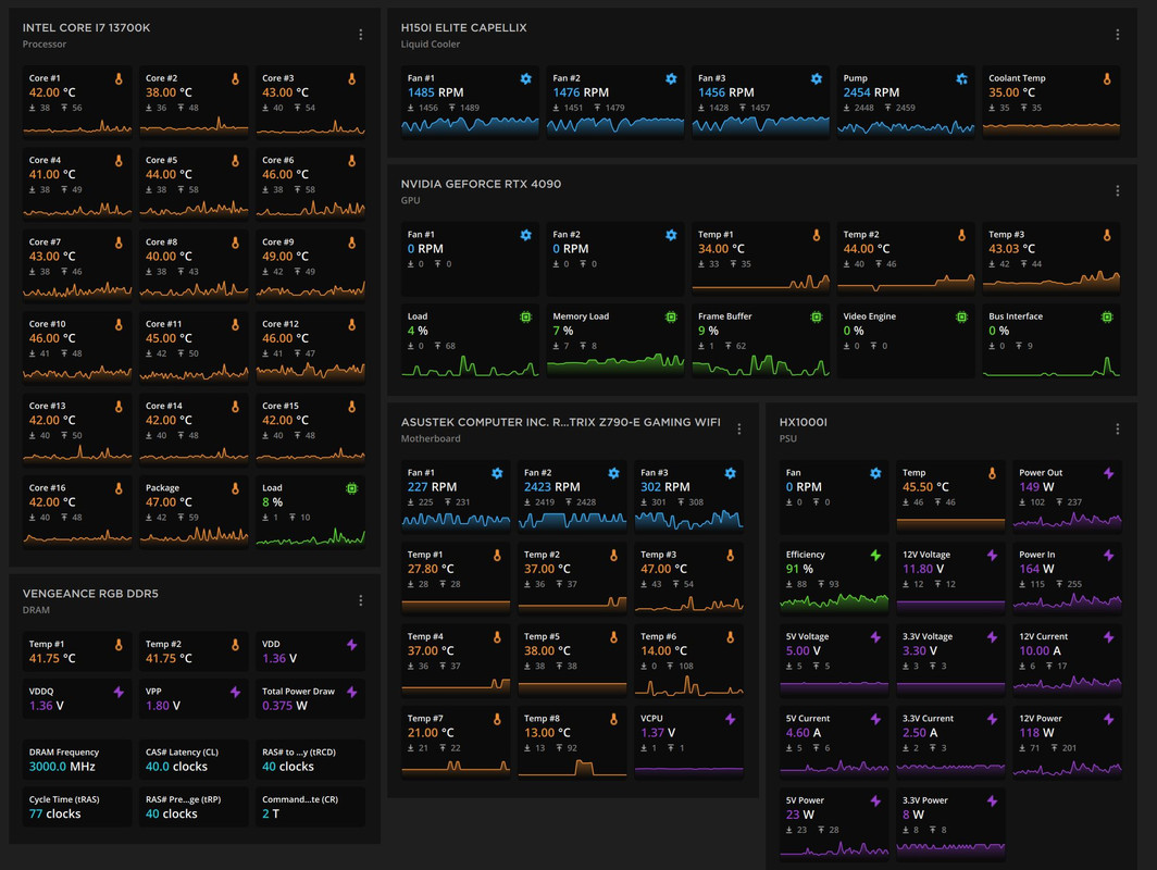

Installed AIO 240.. did a 5min stress test on CPU. What is current throttled? :confused:
