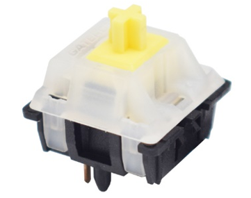

You got the milky yellow gateron right . It's value also less than 50 cents per cap.
What pcb you're using ?
Yep, Gateron Yellow Milky Top, Black Bottom.
AKA Gateron Yellow KS-3-X47. Each switch was like S$0.23 (before shipping). You can also find them on Carousell, saw someone selling each switch for 30cents.
There are other Gateron Yellows.
https://www.theremingoat.com/blog/gateron-yellow-switch-reviewKS-3-X1 is the Milky top and milky bottom. Some say KS-3-X47 is smoother than KS-3-X1.
Using Taobao chinese PCB. Doing a cheap budget build.
