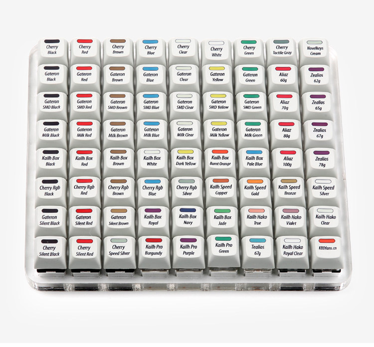

Wah make me gian to buy a Royal Kludge and swap to Yellows
You can consider getting those sample kits, one switch by one switch ones.
Then test and see which switches you prefer the best.
Won't come cheap though, but good place to start if you want to introduce your friends to custom keyboards LOL.
E.g.
https://item.taobao.com/item.htm?spm=a1z10.5-c-s.w4002-16895560065.35.73badc1a3mGAIC&id=580406711470

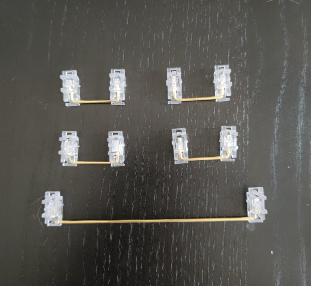

any stabiliser to recommend? dont really like how my backspace key sounds - abit clicky. would prefer a thock sound instead
Nuclear Boy
Dec 19, 2009
22,636
11,934
i see. hope this can last for many years.
I'm not well-versed into custom kb-ising so can only suggest clipping and lubing the stabs. Maybe also bandaid mod if you still not satisfied with the thocc.
I find them quite stable and quiet in stock form, compared what I've used so far, mechanical or not. (Rattly; other than the Model M)
I just bought new Everglide Panda V3 plate mount stabilizers. Almost $12 for the 96/98 key versions. Will let you know if they're good once they arrive.
(Not my picture)
