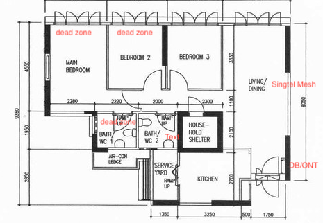

Attached my home layout.
Please advise where can I add my Deco main/nodes if I consider Decos.
SingTel support consult to me that 'SingTel Mesh Router' are only compatible WIFI 6 router to ASUS RT-AX86U and Linksys E9450 AX5400 when I consider to switch to Wifi 6. is this true ?

Do you have LAN ports in the rooms? If yes please indicate the locations of the LAN ports.
What is your budget?
If you do not have LAN ports in the rooms then things become more difficult and you need to significantly raise your budget.
What the SingTel support consultant tells you is totally wrong.

Please explain why it is difficult ?
My budget is around 100 to 200
Thank you
xiaofan
Sep 16, 2018
36,712
12,422
Hello Xiaofan
Thank you
Without the LAN ports in the rooms, it is difficult to meet your needs with S$200 budget, even S$400 may be difficult. One of the cheapest triband AX mesh is TP-Link Deco X68. Tri-pack is about S$499.
https://www.challenger.sg/biz-solut...-whole-home-mesh-wifi-6-3pack0--6935364010201
Budget can be very different between old flats (no LAN ports in the rooms, you may have to use expensive triband AX mesh system) and new flats (with LAN ports in the rooms, cheaper dual band mesh can be used).

Most likely they are using CAT5E or better cable so you can convert the telephone ports into LAN ports. You may have to engage consultant for that.
Hello
Any recommendation ?
Please explain after convert to LAN ports in all my rooms , Deco main and nodes connect on LAN ports ?

Hello Xiaofan
The triband AX mesh for TP Link Deco x68 will help my dead spot issue in my layout ?
If purchase it , where can I place nodes ? It also compatible to Singtel Mesh Router and set as AP ?

Hello Xiaofan
even with a triband mesh router, given the long-ish layout of your unit, connection between nodes might not be strong enough as well.
not trying to doubt you.
8 year old BTO should have lan ports.
Easiest is to go to your DB there. see if those ports that look like telephone points, is it labeled as T or D
Thank you
Yes. You can do like this with cheaper dual band TP-Link like the Deco X20.
ONT -- Singtel Mesh Router
Living room LAN port -- Deco X20 (AP mode)
Master room LAN port -- Deco X20 mesh node
