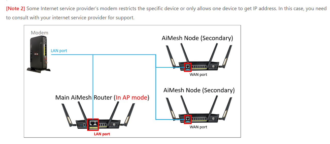

Hello all
In [Note 2] Some ISP restrict IP address , may I know modem in Singtel,StarHub or M1 restrict it ?

Hello all
You can ignore the note for your use case.
In the above picture, the modem is basically an ONR or ONT plus router in the context of Singapore ISPs. Then the note does not apply for Singapore ISPs. In your case, you can think that the modem in the picture equals to Singtel ONT + Singtel Mesh Router.
