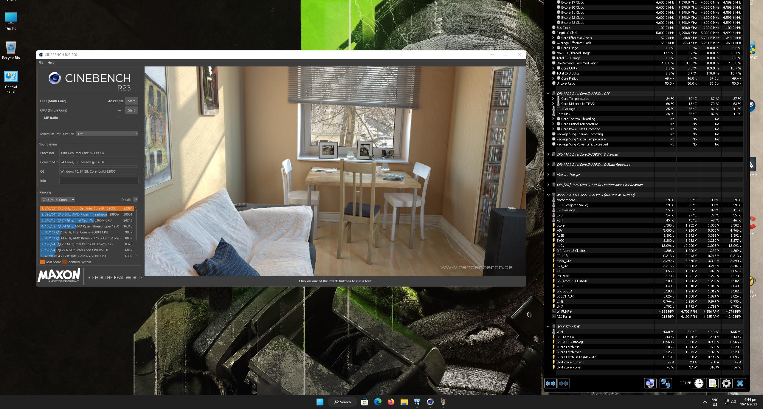

Had abit of time to tweak my setup abit more. Managed 5.6 all core with 2 best cores 5.7Ghz. Bumped E-cores to 4.6Ghz.
This would be the max I can push on my 13th gen and cooling. Might just use this for benchmark profile as games it hits 75 degrees. Earlier one with 5.5Ghz all core with 2 cores at 5.6Ghz only 66 degrees max. Max temps 87 degrees when running Cinebench R23 with 316W. Broke 27k for Timespy CPU score.
Honestly love this Kryonaut Extreme paste. Temps are incredibly consistent.
