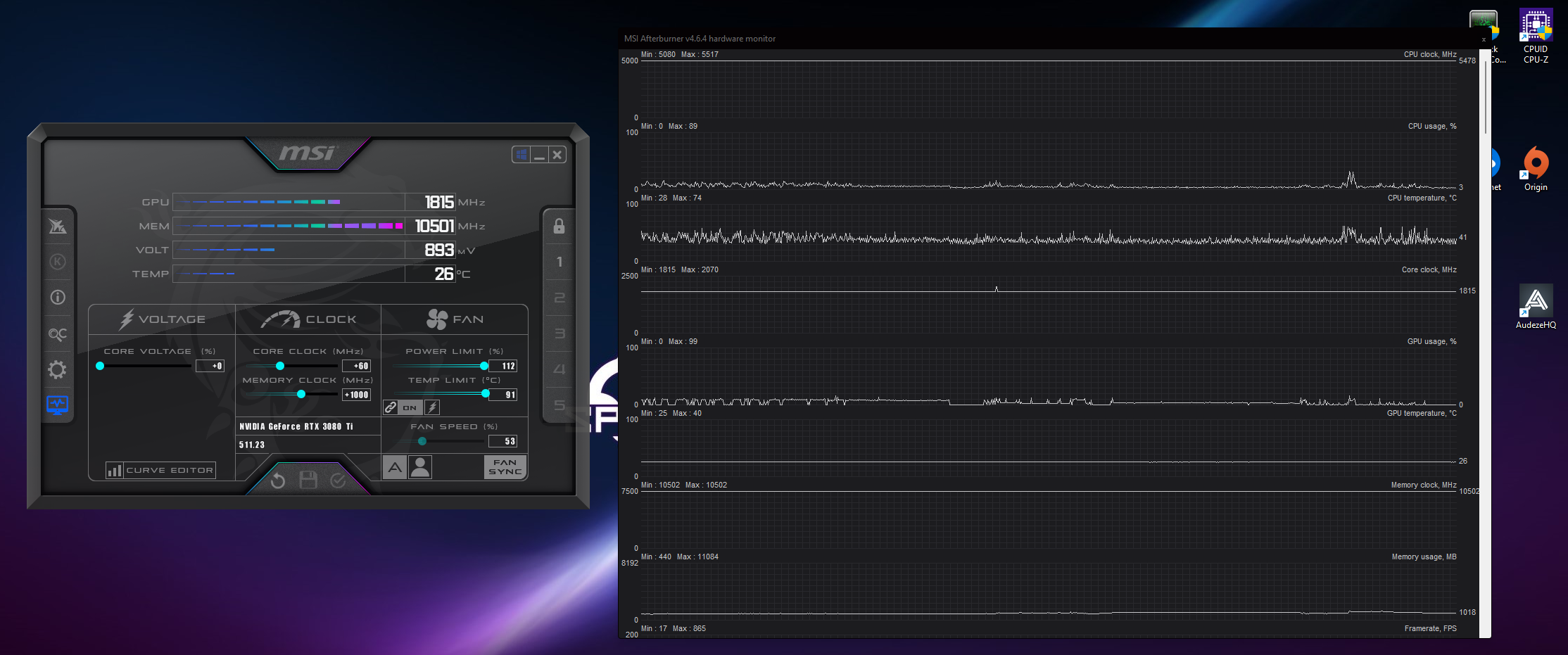

My current temps after a month. Will record a video with my new CPU overclock (5.2Ghz-5.4Ghz in game depending on temps) so you all can see the performance of TFX. This is going to be slightly more than a month since I assembled my system. GPU temps and Hotspot remain unchanged till today.

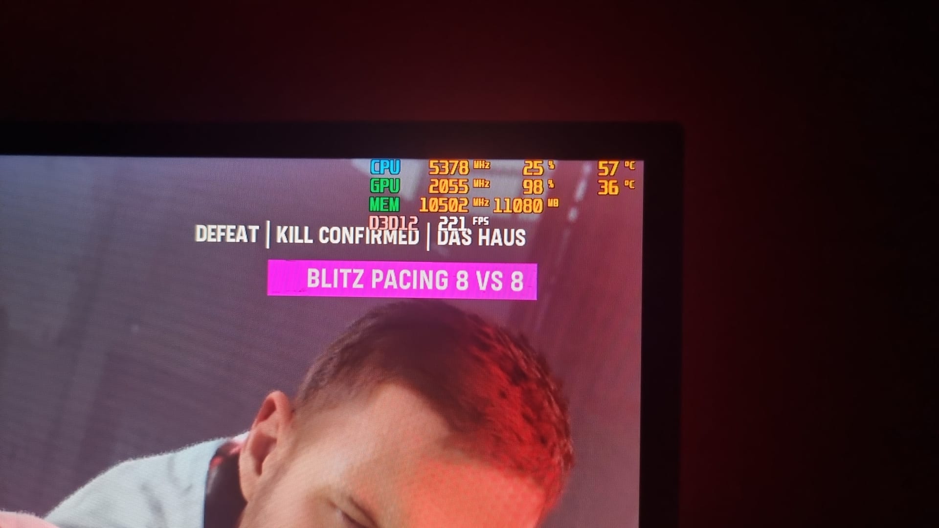

Gaming Session Last Night
Took this screenshot right 5 mins after gaming to show the min/max values. CPU hit peak 74 but if you look average in game is around 60s only. Both CPU and GPU pasted with TFX (Nice and Even Spread) more than a month ago with no variance in degradation on either CPU or GPU.
