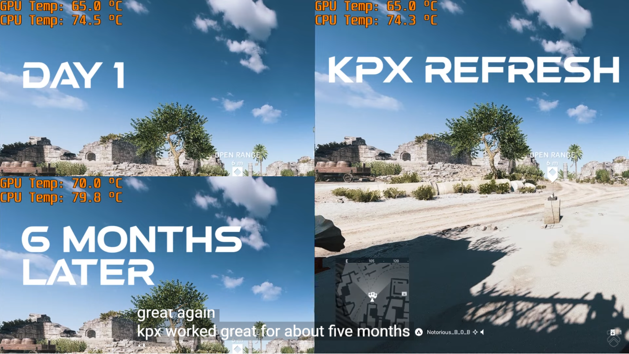

Anyway, what thermal paste do you guys recommend? Thinking to get a new tube. Is MX5 any good? KPX? Kryonaut Extreme?
Edit: just found this video while researching KPX
For testing Methodology, he uses the same values for ambient temps and fan speed in both before/after comparison. Even the game scenario was the same. With these factors in mind, his findings should be quite reliable.
The results show that the performance looks good at first, but later also suffers the same usual problems, double proven by reapplying thermal paste after that. See pic.
