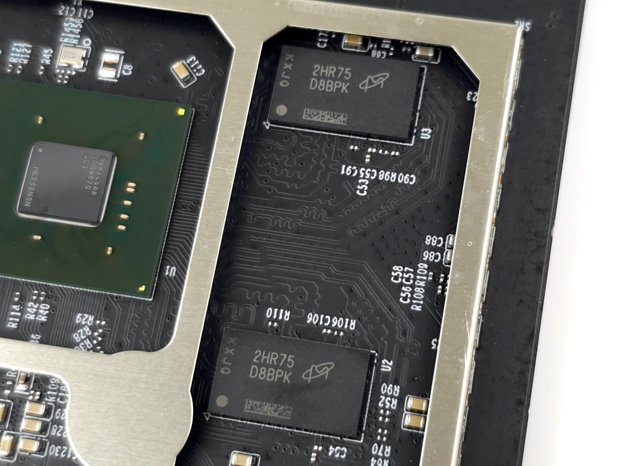

Here is more detailed review of brother be800, seems to use IPQ9570 and not IPQ9574. I think the different is 4 variant have onboard 2.4ghz wireless for some reason
Indeed looks that 2.4GHz wireless integration seems to be the differences between IPQ9574 and IPQ9570. Same for IPQ9554 and IPQ9550.
Ref:
http://www.bitswrt.com/wifi7
More info about WiFI SOCs from Qualcomm
https://wikidevi.wi-cat.ru/Qualcomm
Known devices to use Qualcomm WiFi 7 SOCs. Take note Asus uses Broadcom BCM4916 (quad-core Arm Cortex A53 at 2.6GHz) in their WiFi 7 routers as of now. IPQ9574/9570/9554/9550 should be faster than BCM4916.
