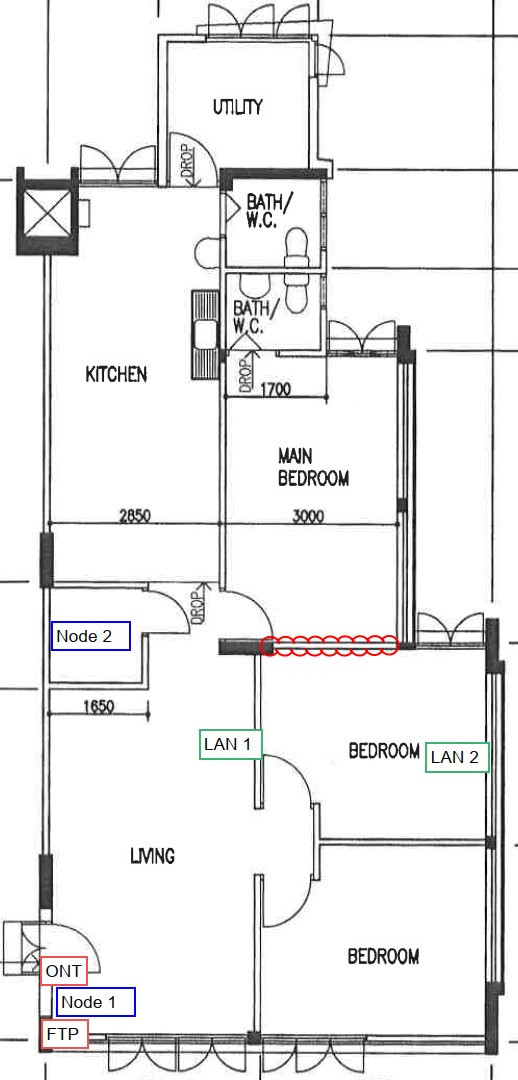

Managed to find the original floor plan when i first bought the house....
https://freeimage.host/i/db6kYmB
I've hacked down the wall i marked in red so can ignore that wall - itz one big masterbed room now. LAN 2 area is our work/ study area.
Node 2 appears to be in the storeroom, but i've also tore that down such that it becomes an open dining area...
I've been reading a bit on ethernet backhaul but dun really understand how it works....

You may want to post the floor plan with details of the locations of the ONT, EB810v and the intended location of the Archer C64, as well as the LAN ports locations. Placement is important to have better roaming performance, even if you use EasyMesh.
That being said, I strongly recommend you to ditch Archer C64 and get another EB810v if you are not tech savvy.
You can use your existing Linksys Velop MX4200 (triband AX4200) to move Node 2 to LAN 1 location to see if that helps on the . Ethernet backhaul is much better than wireless backhaul in general.
Still with your floor plan, maybe three nodes is needed to have good wireless for father toilet, because LAN 1 and LAN 2 locations are not so good.
What is the black colour thingy to the left of the red line?
Maybe pulling an Ethernet cable from FTP to the kitchen area (or from LAN 1 to kitchen or main bedroom) is a cheaper solution than going with three nodes.
Ok let me make sure i understood this correctly.....
Firstly, i'm not using any switch, so my current set up is FTP -> ONT -> Node 1...then i use the LAN ports from my Node 1 to pull 2 ethernet cables to LAN 1 and 2....
So if i were to move Node 2 to LAN 1 location, i just have to connect an ethernet cable from LAN 1 port to the WAN port on my Node 2 to activate the ethernet backhaul?
I did have this idea you shared with me in mind, but dunno how and whether the ethernet backhaul will work in this config....
Much appreciate your inputs!
p/s: the black color thingy beside the left of red line is a wall....
I assume your LAN 1 and LAN 2 ports are physically present, right? And you have already pulled Ethernet cables from Node 1 to LAN 1 and LAN 2, right?
FTP --> ONT --> Node 1
Node 1 LAN port 1 --> existing Ethernet cable --> LAN 1 --> Node 2 WAN port
Node 1 LAN port 2 --> existing Ethernet cable --> LAN 2
You may want to read the following article from Dongknows about the general consumer mesh system, including Ethernet Backhaul and Wireless Backhaul.
https://dongknows.com/mesh-wi-fi-system-explained/
That wall may block the WiFi from the Node 2 (if put to LAN 1 location).
That wall may block the WiFi from the Node 2 (if put to LAN 2 location).
Yes, you understood my current set up correctly....ok will give this config a shot and see if it improves the overall connection stability....
anyways, pulling another Ethernet cable to the kitchen area is not possible....so assuming if i went for a 3 node option, where should i place my 3rd node? I assume it would be somewhere in the kitchen right?
1. Yes I think that is the right option. You can of course experiment with the location to see where is the best location for the third node.
2. But I will suggest to get two units first to see how it goes first. It could be that two nodes is already good enough for your use case. You can carry out experiments to put node 2 in different location to see if it is already good enough.
1) Node 2 placed in LAN 1 location (Ethernet backhaul)
2) Node 2 placed in LAN 2 location (Ethernet backhaul) -- by right this may be worse than Option 1).
3) Node 2 placed in current location (Wireless backhaul)
4) Node 2 placed further up in the kitchen (Wireless backhaul)
3. If all the options are not good, then go ahead with 3-nodes solution.
Henry Ng
Aug 9, 2011
17,194
1,010
May be LAN 1 location put the node 2 at a higher position. It may work fine as the node is high high there so the wifi signal will flow downwards.
