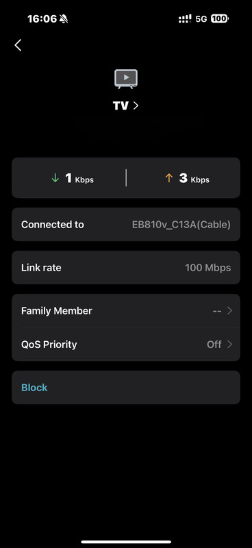

Hi, want to check I connect my tv with EV810B, but the link rate 100mpbs only, is that lan cable problem?
