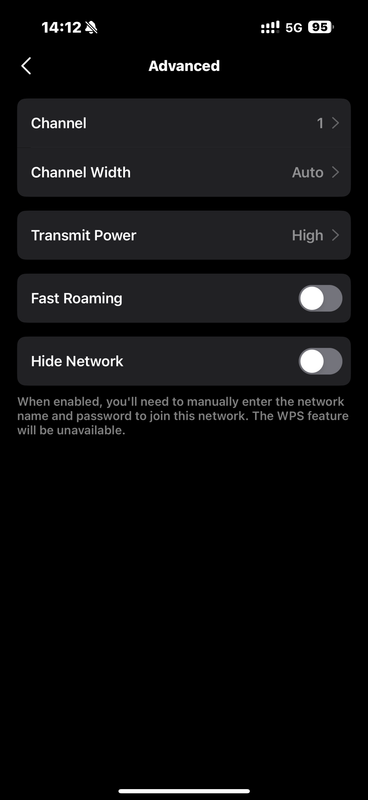

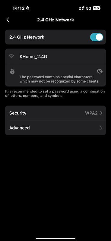

Okok, previous setting is WPA2/WPA3, I try change to WPA2, see if can improve. Thanks.
Other than this, is that dynamic IP or Static IP will affected?

Not really into smart devices -- hopefully you will see improvements.
One change required -- use 20MHz channel bandwidth in Singapore. Do not use Auto or 40MHz.
You may also check whether CH1 is the better channel to use or not. But that may change from time to time so maybe it is easier to leave it as auto.
As for Static IP assignment for the wireless clients, not so sure about that. I tend to think it may help if you don't mind the trouble to do that. It can be a bit tedious if you have many such clients.

can i know the reason why?
Congestion. This is the common recommendation for 20MHz nowadays, no matter for household or enterprise.
Common practice for channel bandwidth to use, for home and enterprise:
2.4GHz band -- 20MHz for home, 20MHz for enterprise
5GHz band -- 80MHz or 160MHz for home, 20MHz/40MHz for enterprise
6GHz band -- 160MHz or 320MHz for home, 40MHz/80MHz for enterprise (80MHz for US, 40MHz for Europe)
One reference (more from enterprice point of view, but the reason to use 20MHz channel bandwidth is the same for home users in Singapore).
https://www.cbtnuggets.com/blog/certifications/cisco/when-to-use-20mhz-vs-40mhz-vs-80mhz
2.4 Ghz WiFi: 20 MHz vs 40 MHz
If you're using 2.4 GHz, the answer is simple. The best bandwidth for 2.4 Ghz is 20 MHz.
In the majority of cases, using wide widths on 2.4 GHz isn't worthwhile.
The performance tradeoffs from interference on overlapping channels will likely outweigh the throughput benefits. One possible exception to this rule is remote areas where there are not many other Wi-Fi networks or devices.
Additionally, 2.4 GHz Wi-Fi and 20 MHz channel widths offer the broadest range of client device support. If you need to support legacy devices and Wi-Fi standards like 802.11b or 802.11g, you'll need 2.4 GHz and 20 MHz.
