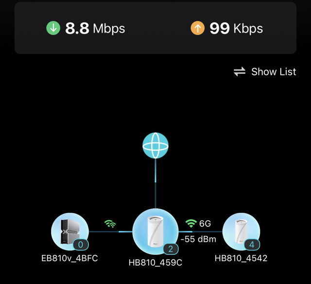

wow...
didn't know you can mix & match HB810 (from ST) and EB810v (from SH)
Both models were advertised as being Easymesh compatible, hence they would be able to work with each other i assumed. Took the plunge coz i got the EB810v cheap. Can't really find a cheap HB810.
