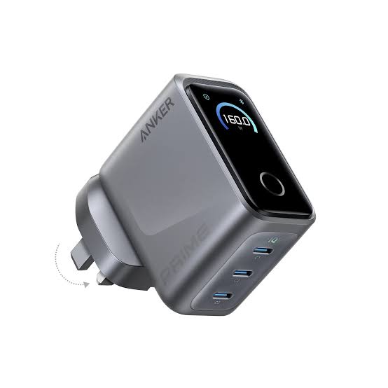

So what charger is satki for travel? Can charge 2 phones fairly quick? Min 100w? At the same time can charge a lappy no need at the same time, good to have
