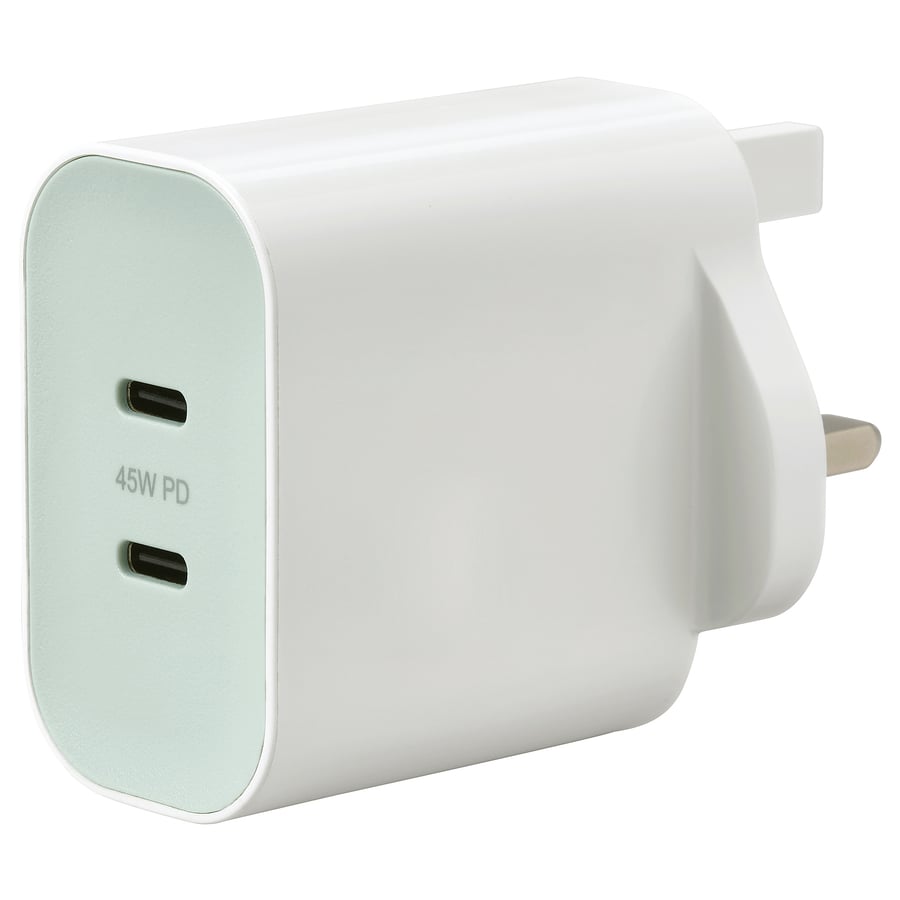

Get the Ikea one
seriously this thing is good enough and only $20 now.
https://www.ikea.com/sg/en/p/sjoess-45w-2-port-usb-charger-fast-charging-80574457/
