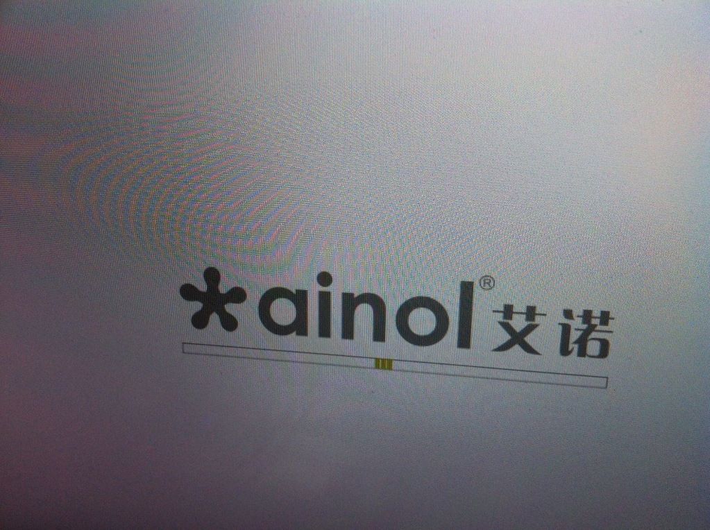

jialat..
now my tablet show me white screen ainol..
kena brick liao???
siao liao...
:eek:
