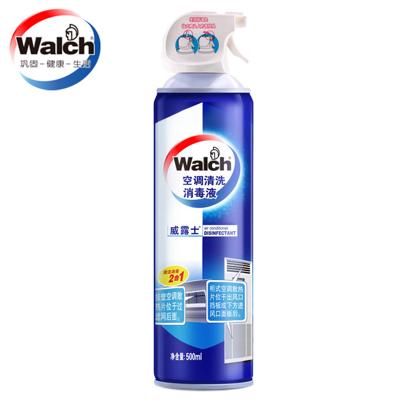

If you are talking about preventing mold, esp black mold which would be responsible for triggers of allergic rhinitis and asthma which most of us are interested in (of coz responsible for other diseases as well when present in higher concentrations but not so common for us folks).......just use a suitable anti-mold spray. I am using Walch disinfectant spray which is a 55% ethanol + 0.05% chlorxylenol (dettol) aerosol spray. I got it from Taobao via Ezbuy Prime, so basically it was like S$5.50 per 500ml aerosol.
It also contains a bit of Triclosan @ 0.03% if i rem correctly, that ingredient would not touch black mold.
You can get similar disinfectants in NTUC, but more ex.
But seriously you can go to Sin Chong and get $7.80 1L bottle of 96% denatured alcohol. 70% is effective for treating mold already, so you might wanna dilute it a bit. So that's $7.80 for 1.3L of product, quite a fair bit for the money. You'd probably use about 100+ml of the product to spray inside.
I use a mixture of the Walch and denatured alcohol diluted a bit, after i DIY clean my FCUs.
But first and foremost, cleaning the FCU works best, followed by these anti-bacteria and anti-mold treatment. Actually anti-bacteria not much of an issue for us, the issue is the mold which is a known allergen for our rhinitis and asthma and of coz just makes us feel screwed up. A certain type of toxic black mold produces mycotoxins when it's high enough in the infestation, and esp if you go disturb the mold by cleaning action (eg physical scrubbing etc), so be very careful esp since the air-conditioner has a blower in which it'd ACTIVELY spread and circulate whatever toxins it can produce.

I am using this aerosol to help control mold re-population after cleaning, hopefully slows down the re-growth and it'd be due for cleaning again before they can gain a foothold.
The Sin Chong denatured alcohol is more cost effective, but this is much more convenient. Anyway, the Walch is not very expensive also at just $5.50 per 500ml aerosol can lah. Each time each FCU 100 ml of spray is more more than enough to soak all internal surfaces and areas behind the blower, the blower itself etc.
In real life, i use both to whack.
Got from Ezbuy Prime. Taobao...... but of coz cannot ship aerosols.

Walch is a legit china brand btw. NTUC is selling some of its disinfectant products and detergents.
Up to 55% ethanol
0.055% chloroxylenol (dettol)
0.055% triclosan
First 2 ingredients control mold.

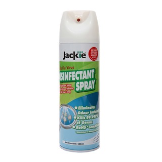

If you were to go NTUC, you'd find that many of those disinfectant aerosol sprays are also 60% ethanol. Dettol, Jackie etc. I think only Lysol has additional stuff.

Can also use Jackie or Dettol or Lysol air, aerosols.....but basically more expensive versions of the Walch (the Walch has additional chloroxylenol and triclosan but triclosan not really applicable in our AC FCU cleaning use) and deifnitely more expensive than DIY manual/pump pressurised spray with denatured ethanol that you dilute a bit yourself.

Ingredients: ACTIVE INGREDIENT: Ethyl Alcohol, PROPELLANT: Hydrocarbon
Ingredients: Propellant: Hydrocarbon, ACTIVE INGREDIENT: Ethyl Alcohol (60%)
